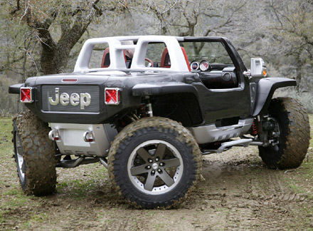

Belive it or not, this used to be a Gladiator
I'm undecided on this buggy
I really wanna see it off road

I was going to put that on,but it's not built, so I figured it shouldn't qualify. Cause a auto enthusiast like you and me didn't put it together.
But with 2 hemi's and that kind of vehicle weight, it's hard to imagine that it wouldn't perform.

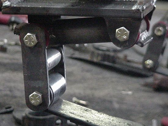

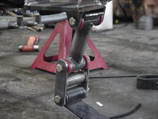

I like his 4 link set-up and his shackles are pretty cool too....

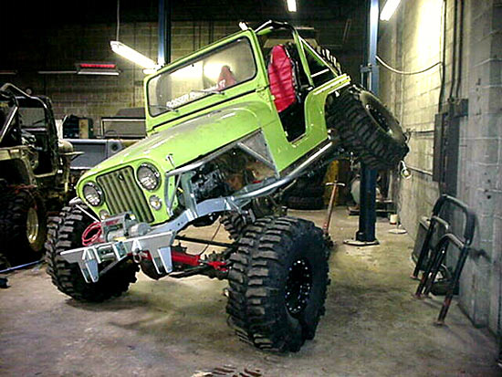

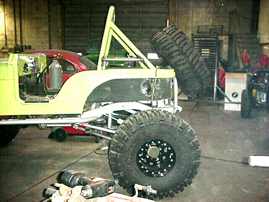

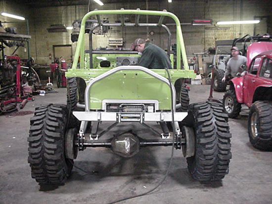

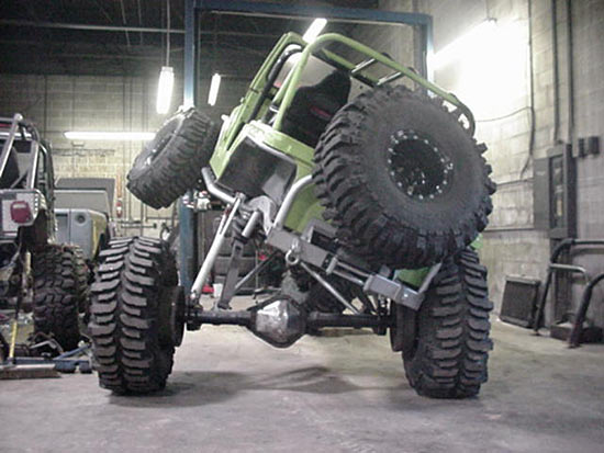

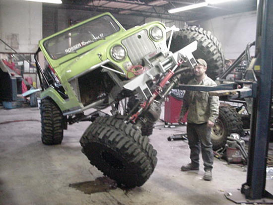

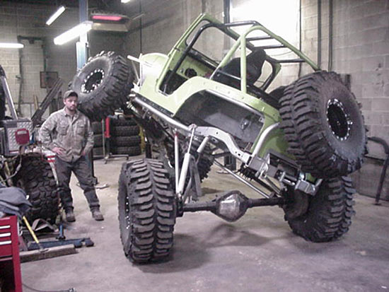

Another trail rig built by XTV Engineering..... does anybody know how to contact them?

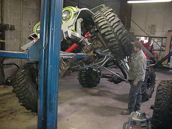

How in the hell did he get it to flex like that?
RE: lincoln locker, quick question
The frame is jointed.
They are out of business. The guy that ran that place was not a good business man and full of BS. I vaguely know the guy that green Jeep was built for. He spent nearly $40K getting XTV to do the work and then had to re-do most of the suspension afterward. It looks cool in the pics, but was poorly designed. That front shackle drop thing will not work and will break u-joints in a second. Think about which way the pinion points when it drops down like that.
I heard that during the test drive the suspension bottomed out and went throught the oil pan on his brand new LS1.
The first time I met the guy who owned that shop, he was giving me the grand tour and showed me some junked up buggy they were putting together. He told me he invented the hydraulic steering that was on there. While hydro was still relatively new, I told him I had just got back from Hot Springs where I saw no less than a dozen Jeeps running the same set up. He also did not know that I was a hydraulic specialist. Like I said he was full of BS. He gave a black eye to the wheeling community.
