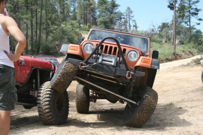

true and he is the biggest retailer of PSC parts in the valley ( Hyrdo steer)...so I can see your point. lol. The main reason I changed to a high steer was the steering liked to fight me when turning with the front lockers on a off chamber situation while trying to turn at the same time.
As you can see with my new steering the track bar and drag link at perfectly parallel with each other, and with the front locker on I am not getting as much feed back from both wheels trying to turn them self back to straight while off chamber. Was told each wheel will try to turn to neutral position (straight), while the "Y" set up allows the drivers wheel to feed some pulsing through the tie rod, into the drag link, flexing it with that side pulsing. Is this true? Don't know? I do know I have a lot more control with a high steer kit.
