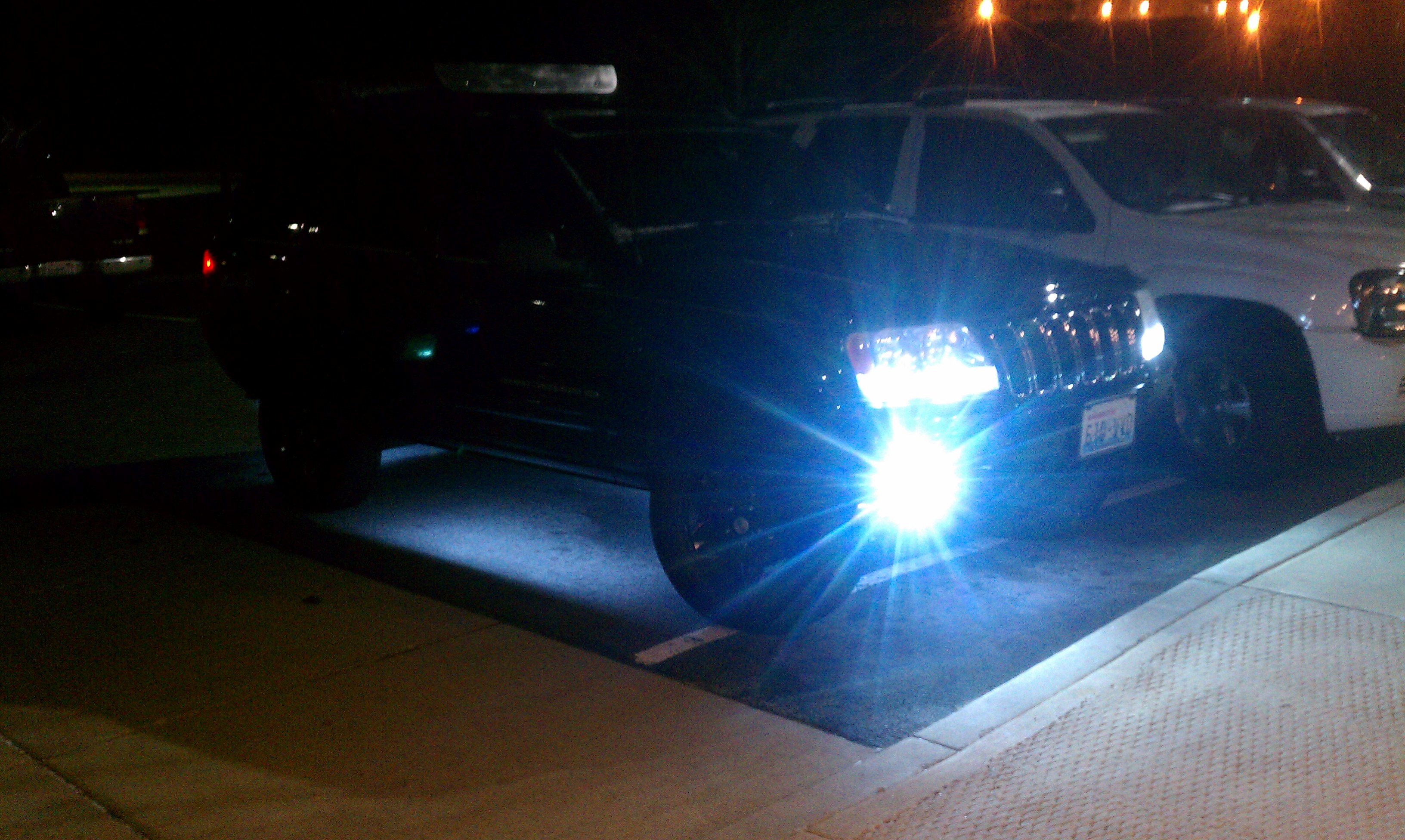

I used LED strips from Ebay for mine and they have been on for about a year now. No issues at all. I have more pics on my personal computer of what they look like from underneath. I am on my work computer now.
