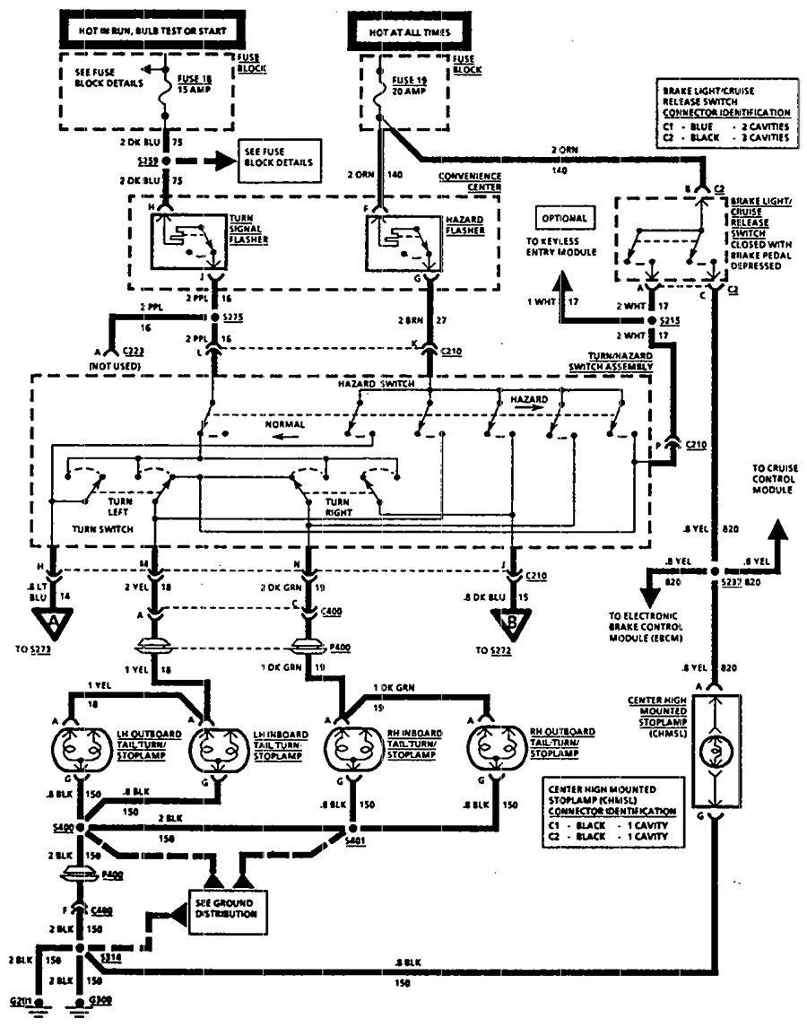

The owners manual does not identify what the relays are for. And forums just don’t know. I imagine it is under the dash or incorporated somewhere but i cannot find a reference. Wiring diagram would work.

Found a diagram. Just need to know where the convenience center is located.

So every forum i came across states since 2005 honda does not us relays. Turn signals are controlled by the MICU (multiplex integrated control unit). But wiring diagram shows what looks like relays. Hmmm
