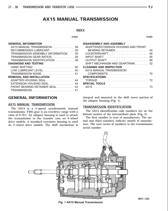

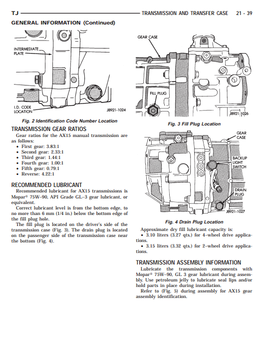

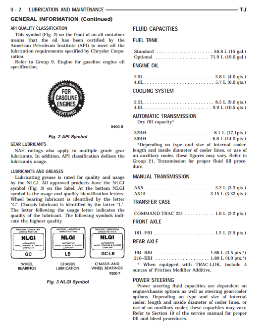

I took a quick look in my 97 TJ manual and grabbed these screenshots
