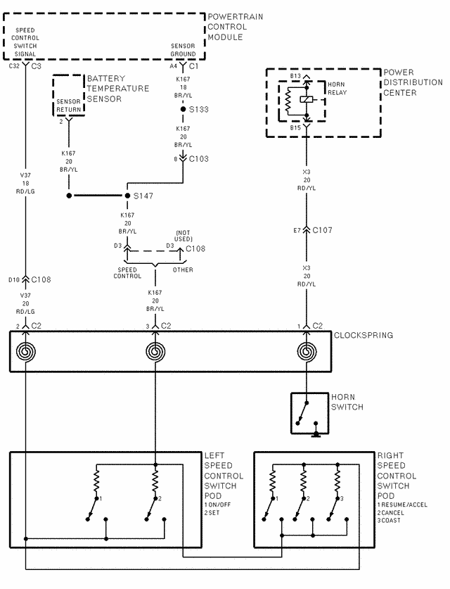

Try this, Remove the upper and lower steering column cover and locate the connector for the clockspring under the column, behind the steering wheel. Disconnect the clockspring and recheck it for the P0123 DTC. If the dtc does not come back after disconnecting the clockspring, replace the clockspring. The thoery is that the 5V supply to the clockspring is shorted to ground and is causing the PCM to have an erroneous dtc of P0123. If this doesn't apply after you've done this test, post back and i'll walk you thru another test..

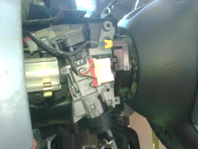

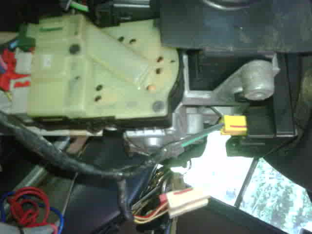

Thank's Todd. That was a shot in the dark. Looking at the schematic diagram ,it made sense and i'm thankful that Dgt didn't ask what the heck that had to do with the TPS cause i would have had a heck of a time explaining that one.:lol:.

As for how the clockspring affects the TPS, relax Mikey I won't ask. I can't tell from the schematic, but when I replace it I will most likely be able to figure it out. Being an electronics geek for a living I am driven to discover the unknown in the electronics world. I will most likely also at least attempt a repair for the old clockspring. I would be surprised if I cannot make it work again.

For the Horn, get a bumper sticker that say's " No horn, Watch for the finger". LOL. As for repairing the clockspring, been there done that, that's part of what i do. The clockspring is a modular unit that has a wound up ribbon wire inside the housing. It usually breaks on one end or the other. They are not a servicable part. Repairs are avoided due to liabilities. Although a clockspring has not been known to deploy an airbag prematurely , i wouldn't risk being the one to be the first one for that reason.

If I wasn't confident in my repair I wouldn't think of reusing the defective part. I will also try to waterproof the replacement before installation. By the way, will the airbag still deploy in the event of a collision if the horn relay is removed? Again, I cannot tell from the schematic.
Yes it will. so as long as the connectors are in place on the clockspring and the airbag lamp is off, the airbag is operational. The connector is yellow in color throughout the vehicle harness.
