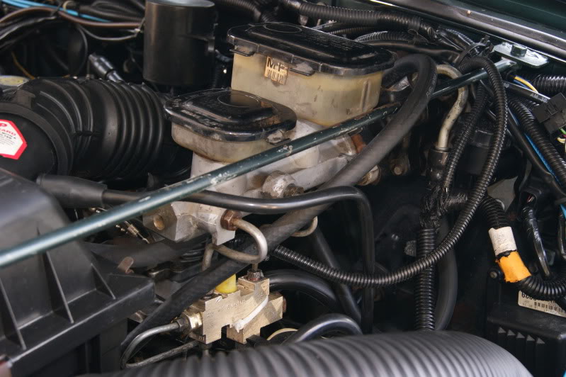

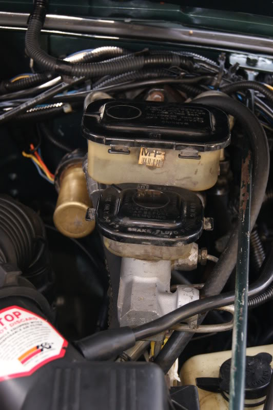

Lets talk about this hydro-boost, conversion. What year did you pull the hydro-booster from?
What about activator arm length? Did you have to modify it?
Did you change out your stock power steering pump?

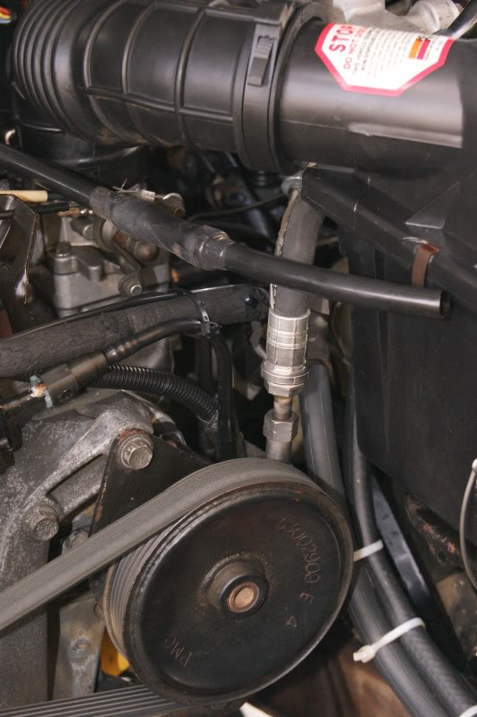

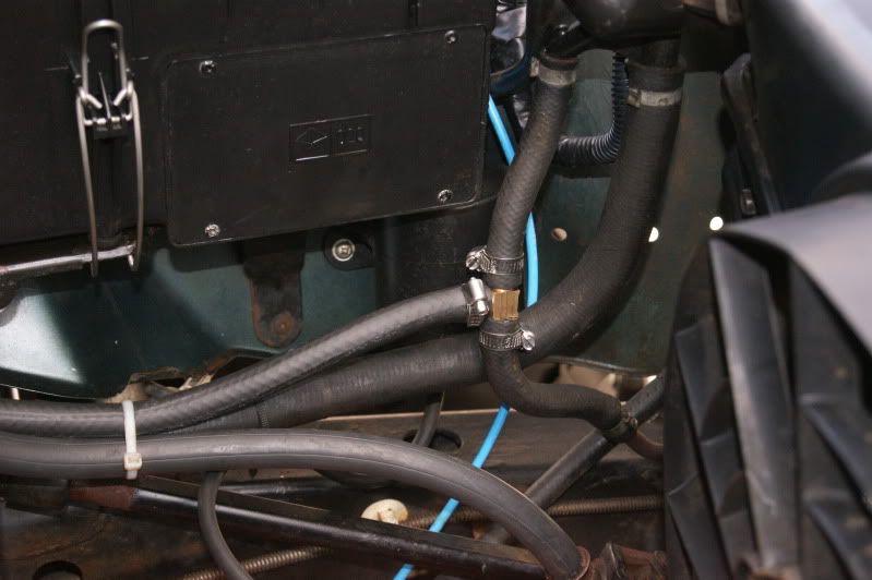

I dont remember the year, but as for the activator length, it was almost spot on. I just modified the brake light sensor a bit (about a milimiter or so) so the light would not stay on permamnently. I am currently running the stock pump, but I am planning to change it, as you can hear it whinning during hard braking or tight turning.

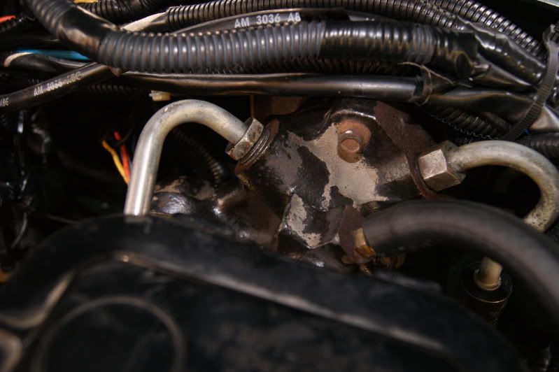

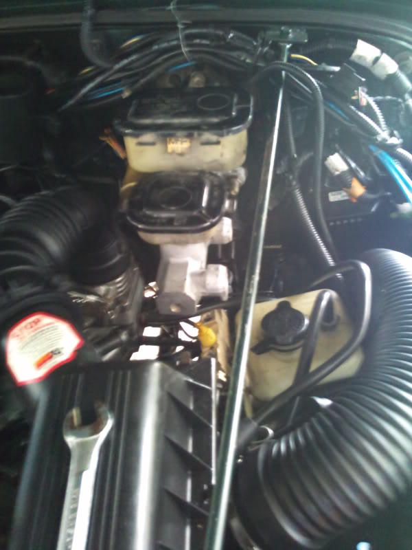

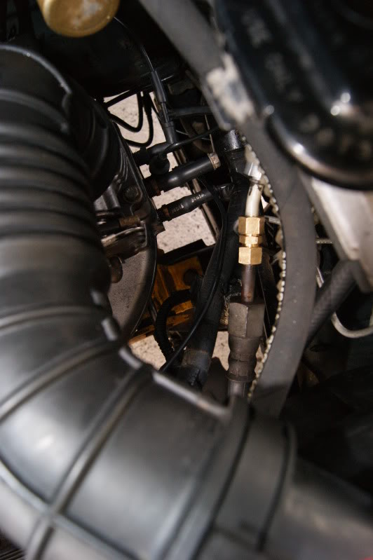

Here are some pics of the setup (a bit old; taken while I was installing it, so it was not finished when I took them):
This one I ended up changing the T connectors to the correct setup...
