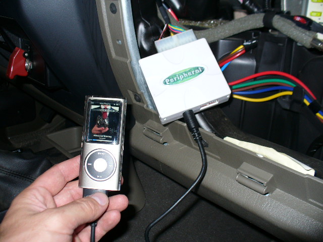

So, I purchased this new thing-a-magigy so I could hook up my iPod and not have to worry about static like the adapters that transmit through the fm stations. This hooked directly into the back of my stock head unit. I can control the basic functions of my iPod right from my stock stereo. I freaking love it! Sounds great! I am going to route the cable through my center console so I dont have wires hanging out all over the place. Well worth the price!
I had some help installing it so I thought I would post a pic. Good help is hard to find these days!

Very nice. Where did you get the "thing-a-magigy"?
And I have to ask, what is the switch with the red cover?

Its made by Peripheral as you can probably see in the pic. I got it from Crutchfield. Installed it last night and it works and sounds great! Ah, good eye there......the switch is a locker override. It allows the use of the lockers in any T-case setting. I was bored one day and had the parts so.....what the hell.

I am not sure if it works with the IPhone or not. You could check Crutchfield or Google the manufacters website to find out I am sure. I had to buy a different cable than the one that came with it so it would charge my 4th Gen Nano (which is 5volt) It would have been nice if they would have told me that......I found out the hard way.

He most likley has a rubi which has a locker in the front axle that only works in 4 lo.It is an electric locker so some people will splice into it and wire up a switch so they can use it in 4 hi also.
