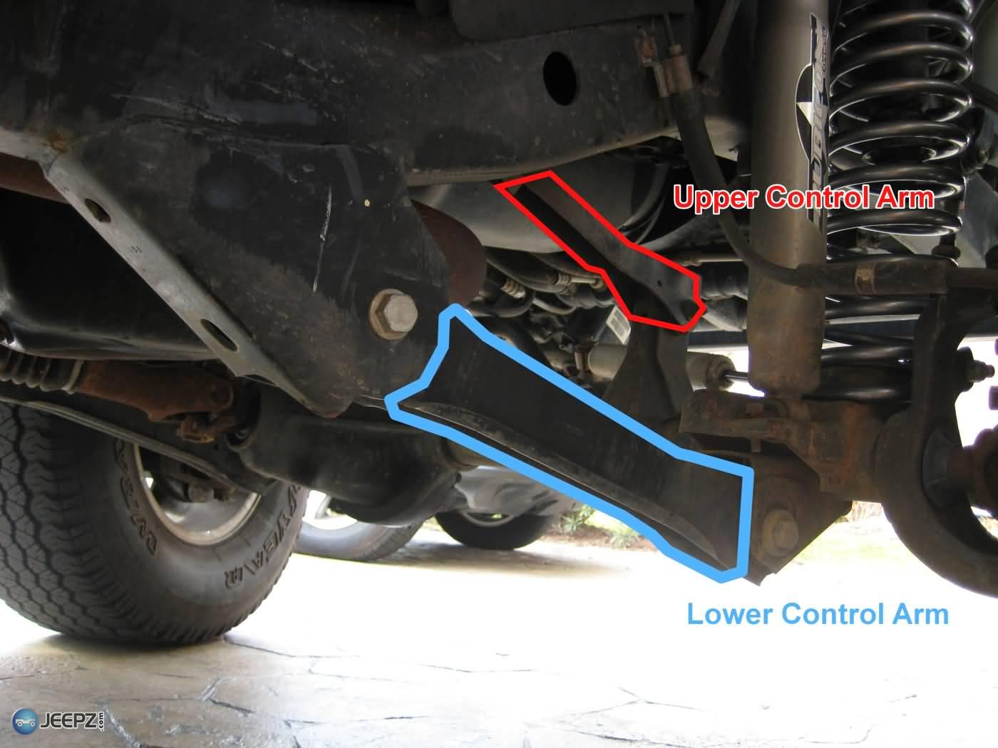

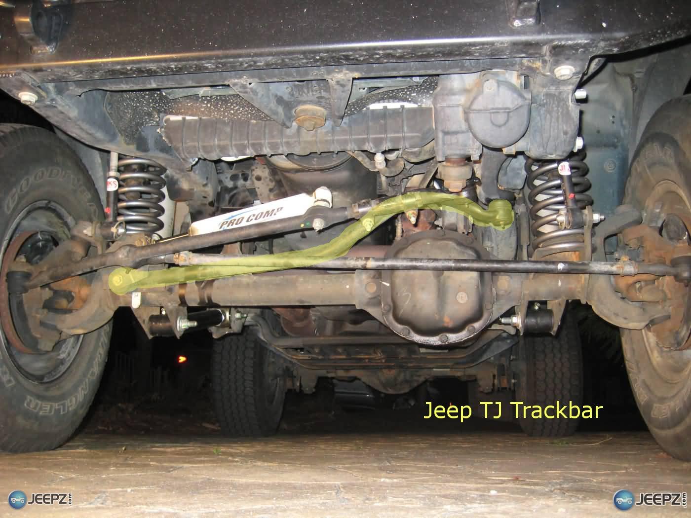

I think that Ggg is right on the money, you'll at least need trackbars, swaybar links, and lower control arms.

I think there's a typo in that description. I think it does come with lower control arms. Adjustable track bars, extended brake lines, an SYE, adjustable suspension links and all that - they're nice, and they do improve ride quality and off-road performance. HOWEVER they are not needed to get the lift installed and get your Jeep back on the road.
The minimum you need to get the Jeep back on the road are longer springs, longer shocks, longer control arms (don't have to be adjustable but that would be nice), extended sway bar links, and a transfer case drop (for a 4" lift, 2" lift can usually get by without this). You WILL have to do a 4 wheel alignment after everything is installed, but as far as track bars, usually a more basic kit like this will come with instructions on how to relocate the stock track bars so that they work with the kit, and they usually come with fixed extended sway bar links (not disconnects). They also usually come with spacers for the transfer case drop. As long as you have all of those parts you will be fine.

I don't know Jason, I'd say that either a longer front trackbar or a trackbar bracket would be a requirement for a 4" lift (although I think I see a bracket in the photo).
I'm not positive when it comes to TJ's, but I just helped a friend install a 4.5" budget type Zone lift on an XJ and it had instructions to simply relocate the stock track bar on the front. I will fully agree that an adjustable track bar or a drop bracket would be ideal (and of course some budget lifts do come with drop brackets) but I don't know that it's absolutely necessary. I could be wrong though...
