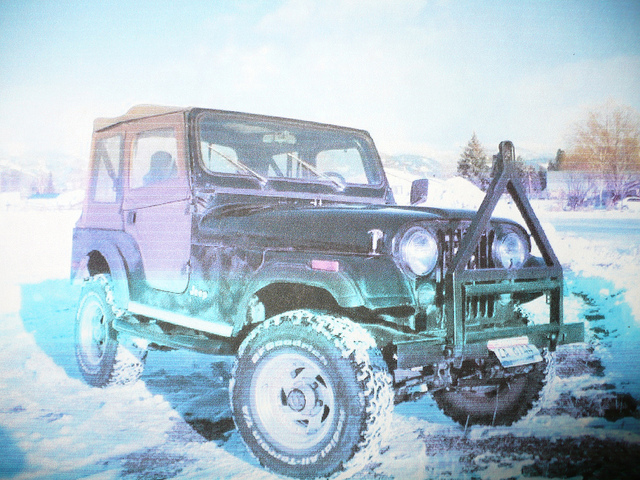

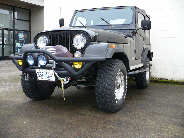

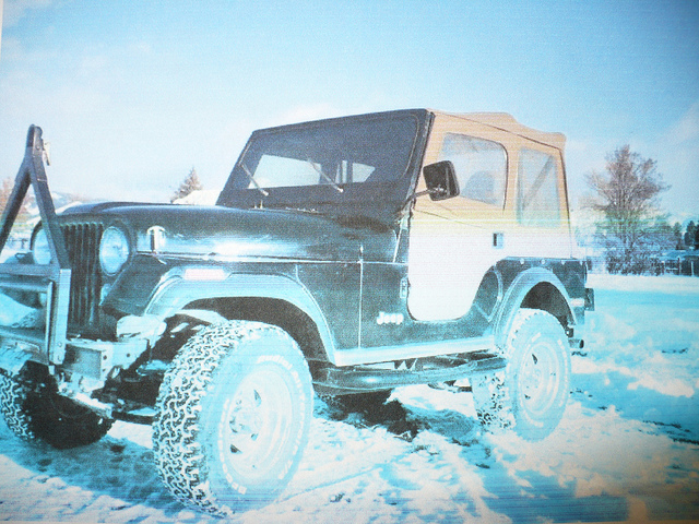

When I first got 'Black Betty' she came from the dry NE Oregon climate (yes, Virginia we do have at least one part of Oregon that's dry) and was an EBay purchase. Surely mine being a '78 as well I knew going in that this $3708 purchase was a bargain, but there'd be work ahead of me. The two primary issues I had to face were a rear axle tube was bent, and the pusher fan installed by the P.O. was not cutting the mustard. These issues, along with a few upgrades and mods have been addressed.
