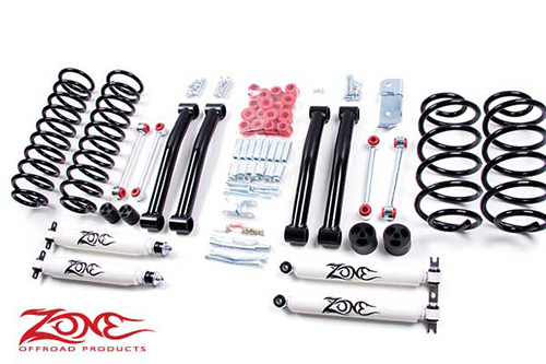

Are you talking about this kit:
4" TJ Suspension System
Prepare yourself for the perfect combination of off road performance and on road handling. This 4" TJ system offers dramatic improvement in both ground clearance as well as wheel travel. The new massive lower control arms not only correct front alignment, but dramatically improve suspension control. These greasable arms can handle anything! This system comes with a transfer case drop as well as rear pinion cam locks that rotate the rear pinion for proper driveline angles. With 4" of lift, you can clear those 33's with room to twist as well as use your Jeep for a daily driver.
Features
Four new Zone coils are included that are capable of being fully smashed down and they will always come back to their original height.
Front and rear extended sway bar links are included. These links come with urethane bushings to increase performance and reduce body roll.
A rear track bar relocation system is included to perfectly center the axle under your TJ.
A minimal transfer case drop is supplied to correct the driveline angle while maintaining as much ground clearance as possible.
2" bump stop extensions are included to protect your vehicle while still greatly increasing wheel travel
Four new massive lower control arms are included. These greasable arms are made from 1-3/4" x 1/4" wall DOM tubing!
New rear pinion cam plates are included to rotate the rear pinion for proper drive line angles.
The system is completed with 4 new Zone shocks that are specifically valved for your TJ to perform well both on and off road.
I've had no experience with it myself, but it looks OK. You'll probably need to buy a front extended trackbar (it comes with a rear bracket). You may want swaybar disconnects as well.

Yes, this is the one. I have a bunch of front end parts. Discos and track bar. I appreciate everyones imput but I'm going with Terra due to there bushings and my cold cold winters.
