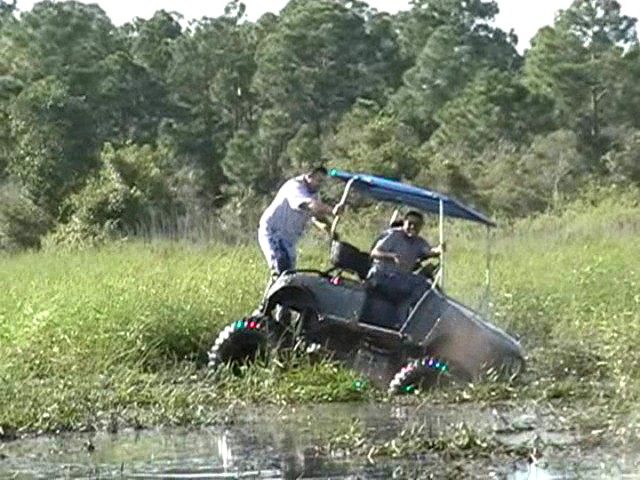

has anyone ever heard of a sycro first gear or a conversion for a t90.
first gear is great in the mud and second gear is great at low rpm on the trail to the flag ponds. the problem is there are deep muddy spots on the trail so i have to stop to select first gear as its not sycro-ed and i dont have the hp to stay in second. maybe they made a trans that would fit with sycro first or a grany transmission that would make second the same ratio as first on mine? any ideas
1969 cj5
f134-t90-t18
dana 41 rear
5.38 gears
40" military tires
