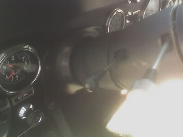

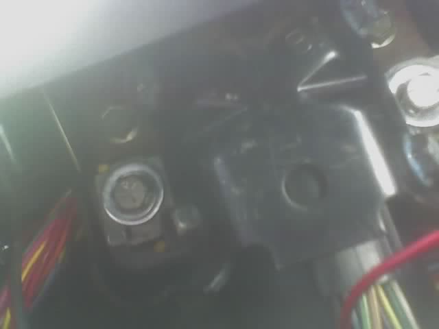

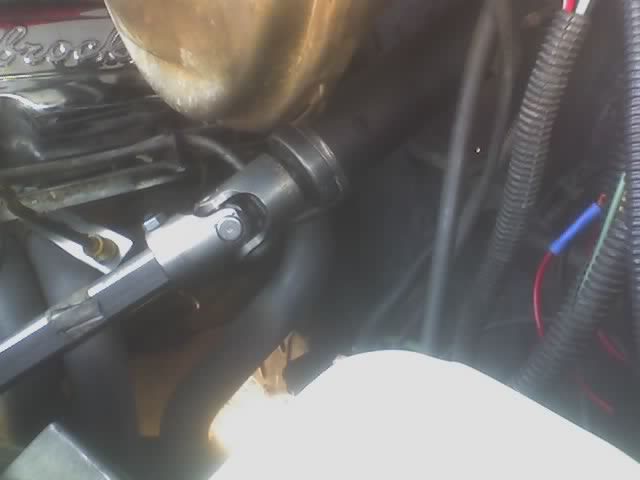

Here's some pics of my column post install;
Wow looks great I hope mine will look so good when I get done. Thanks for the photos I am kind of the visual person can fix it if I can see it.:)
By the way, pic no. 2 Shows the new support fixture I made from plumber's tape albeit HEAVY gauge to support the engine oil dipstick tube~three had broken off before
