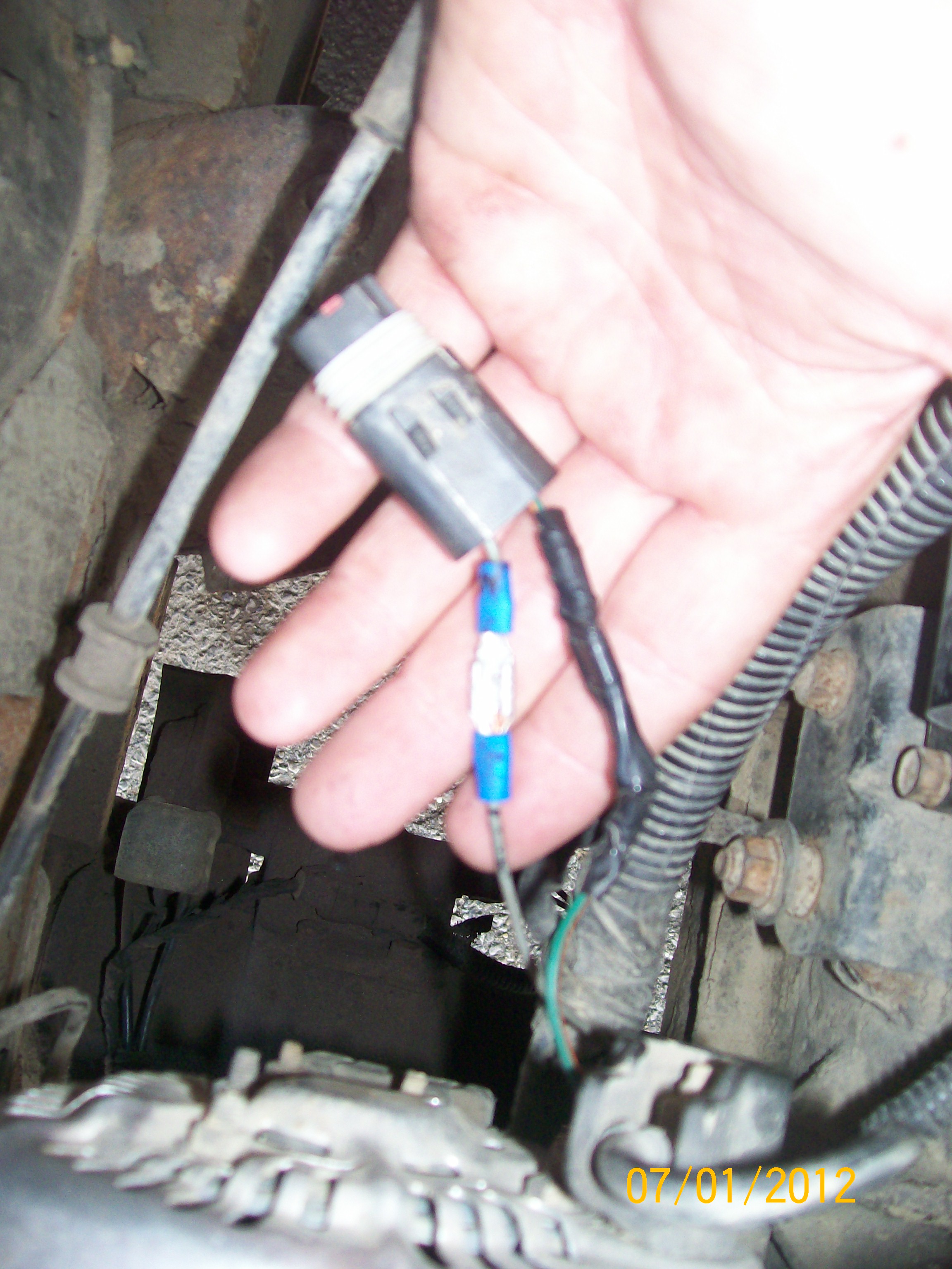

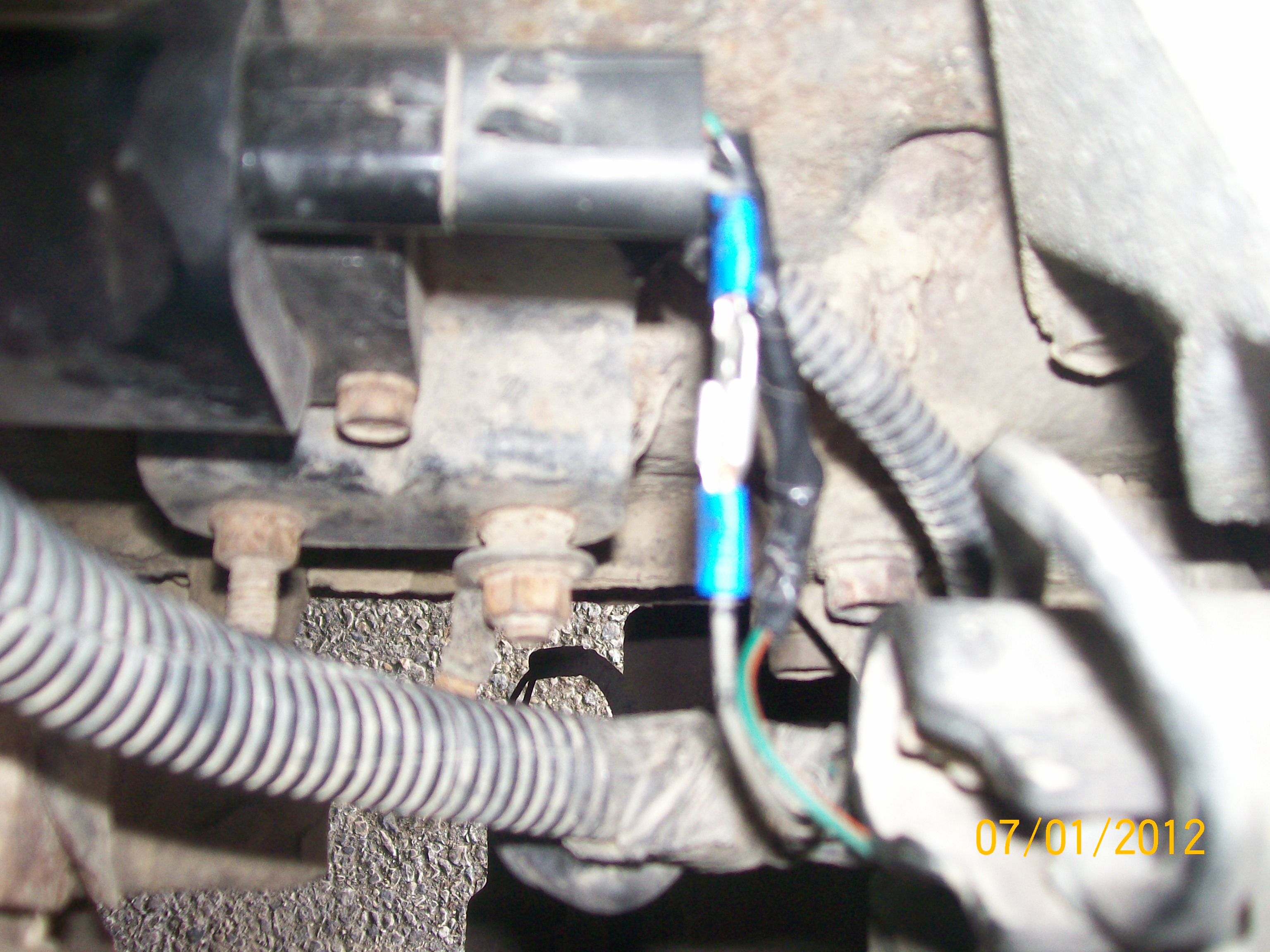

that tune up was done a 3 months ago, but I did find and issue that really rattled me beyond human intelligence. ill try to post a pic so you can see. the wires that I last described that were taped up, I un taped to find male and female spayed but connectors I guess you call it. but the thing is, they were not put together! they were just on top of one another. so I put them together and re taped them. I quit once of a few big pot holes I went over , but not another problem. ( so far) Fixed a couple vacuum issues, may need a fuel regulator, guy at auto zone who has a yj like mine said the diaghram goes bad after a while. Plus he said knowing it takes a while to crank the jeep over he said it may need a fuel pump soon knowing its not holding the pressure. That I really don't want to dig into...
So this plug goes into the coil. where do the wires go? I was told the distributor? can I get a whole new wire harness with real wires that are not broken and a clip to hold it in place??

Im not positive about the wiring on wranglers, but wires coming from the coil usualy do go to the distributer. Cjs have a harness for the engine and one for the interior and tail lights. If you look at where your wiring comes through you firewall, there should be two seperate bundle of wires that plug into a box. If you have the seperate harnesses there, you could go to a junk yard and get a engine harness.
