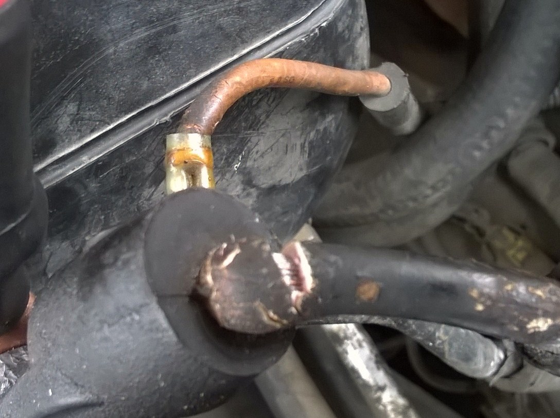

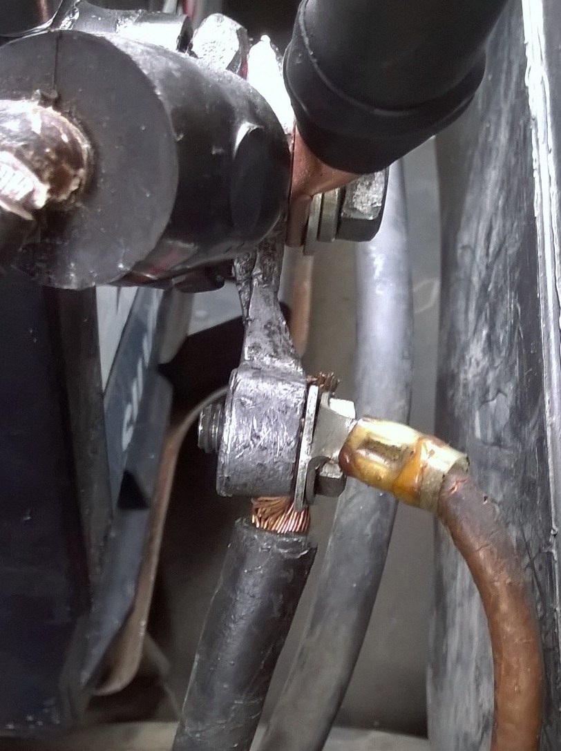

This is the mess I found on my GMC;
Thanks P.O.
