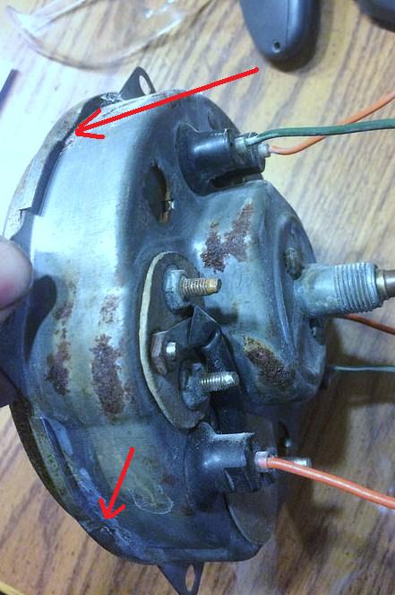

To open up the speedometer for inspection I just pried back the face edge back with a screwdriver.
