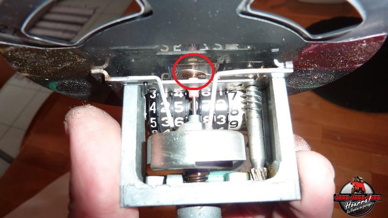

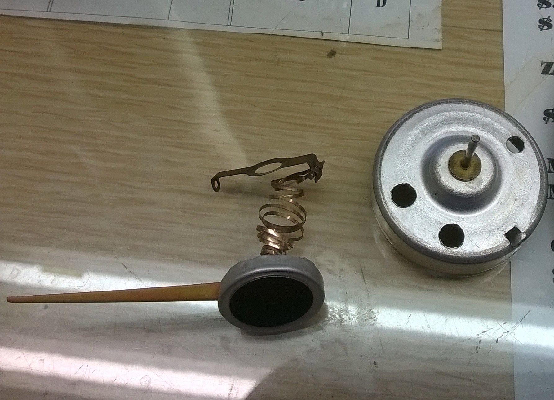

Well, this one went with the cable going out which is a lesson to me as soon as the needle starts jumping around it can damage the spring internals to the point of no return;

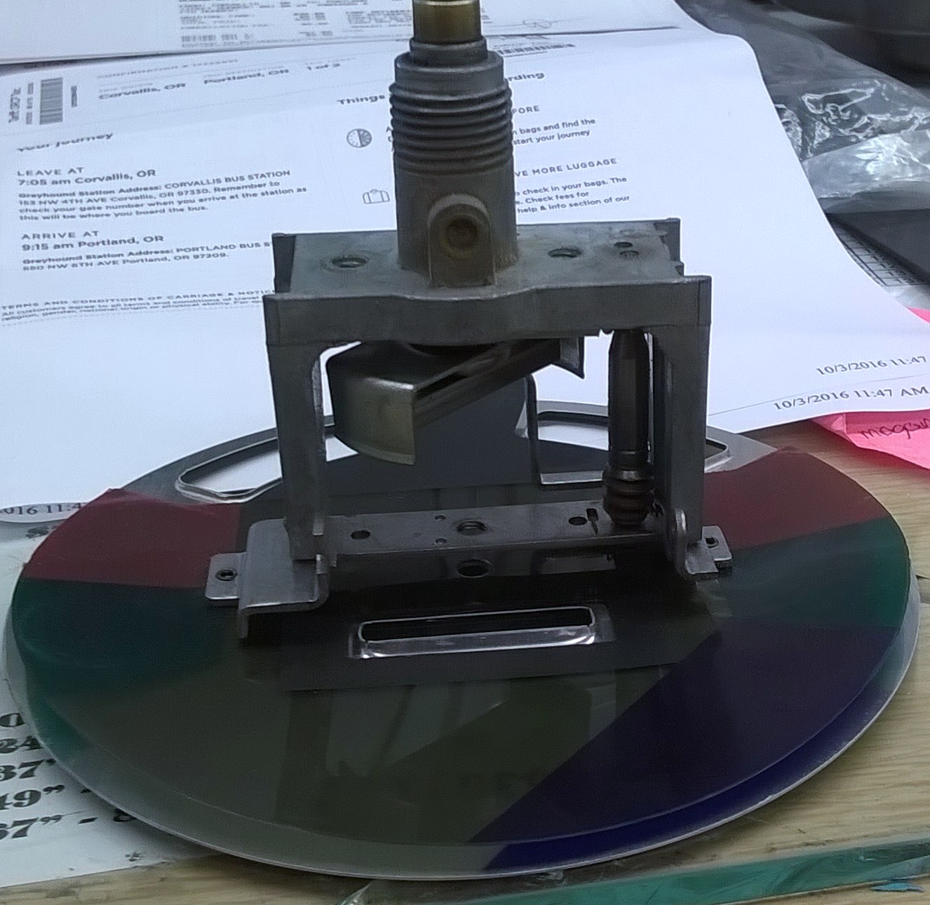

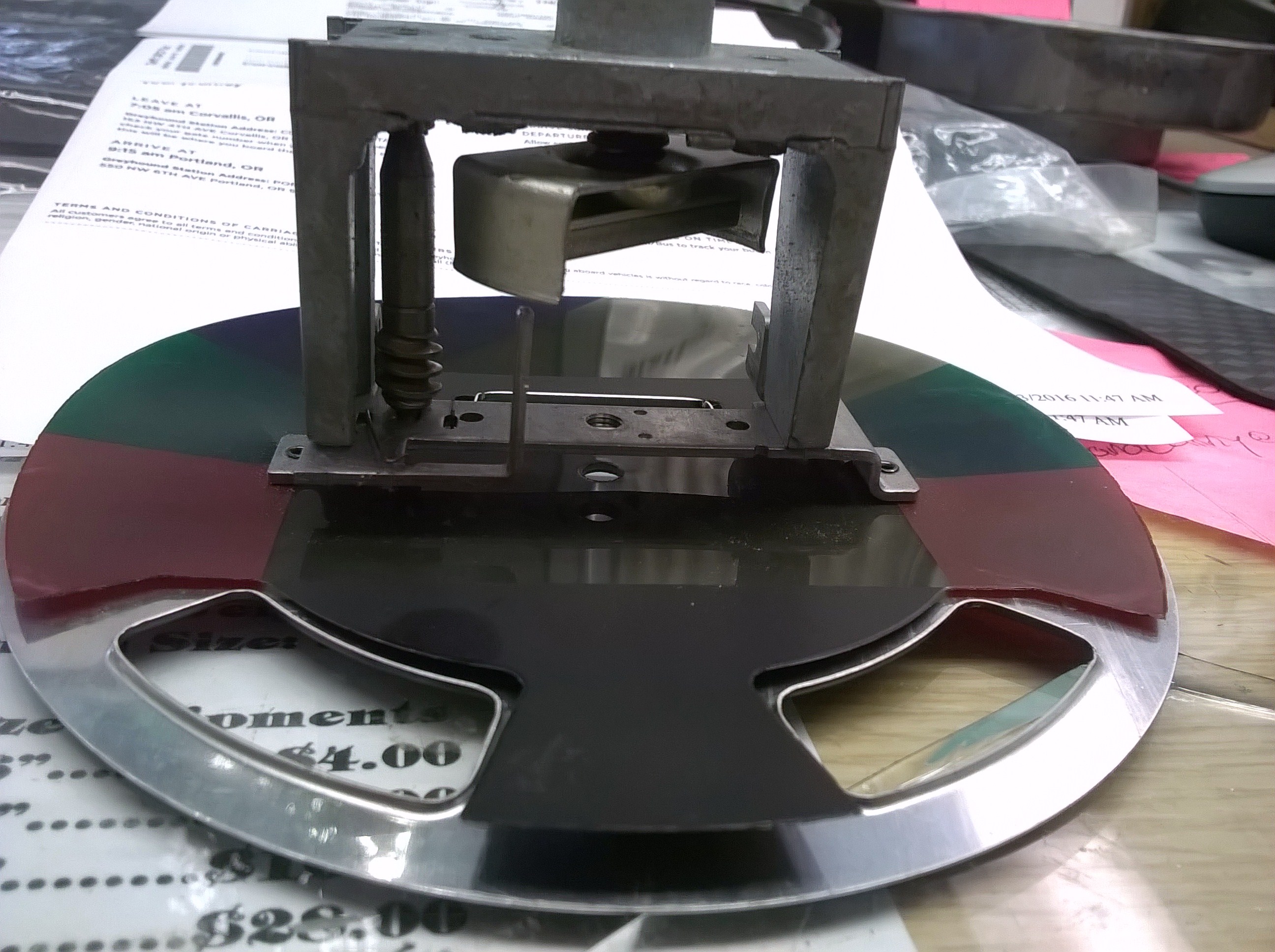

Has anyone ever rebuilt one of these SW speedometers? The cost of a new one is out of reach for me and may be for some time and the internals are incompatible between my spare VDO and this one.
i have not but i would imagine that getting the spring tension correct would be very hard.

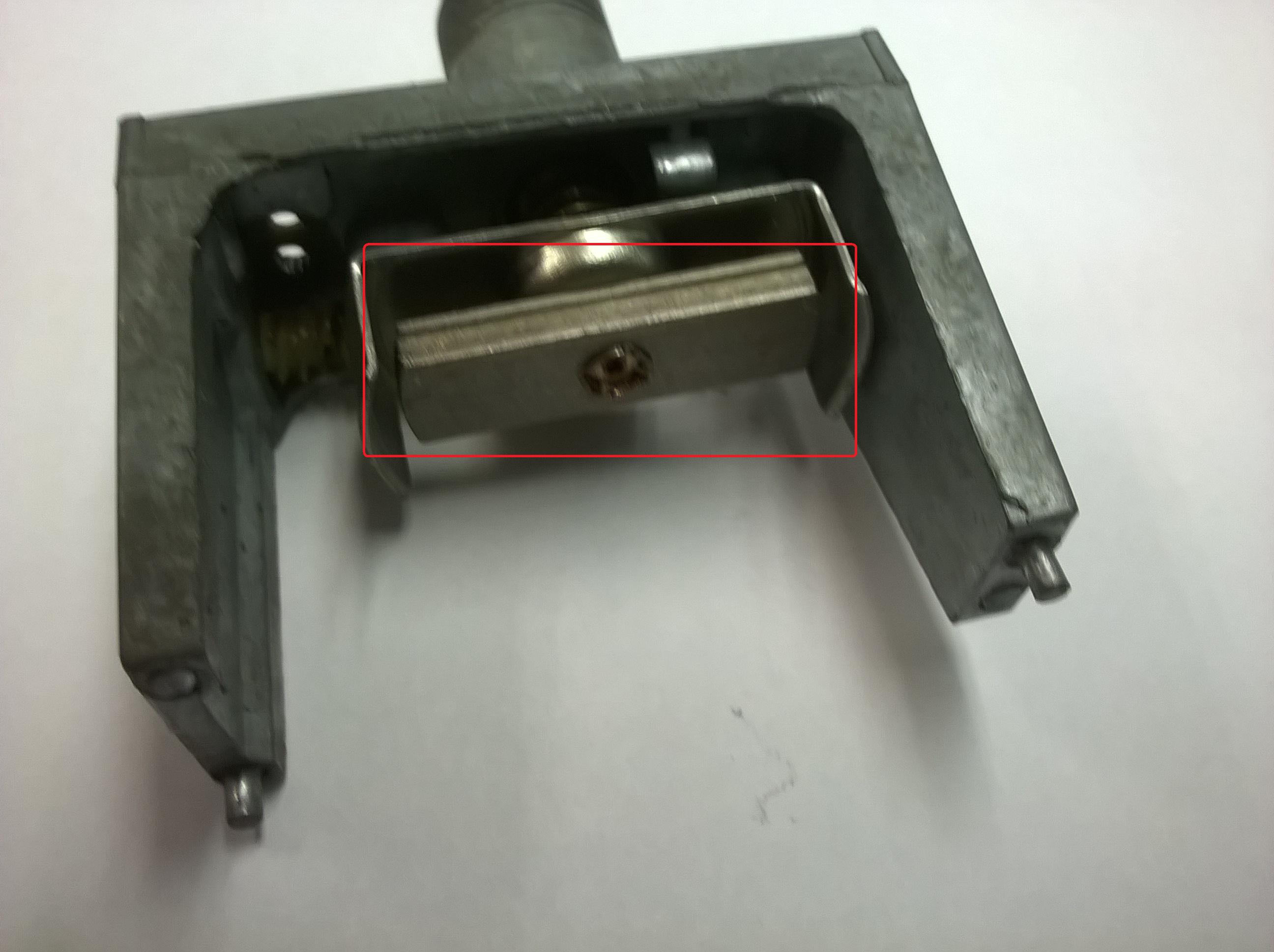

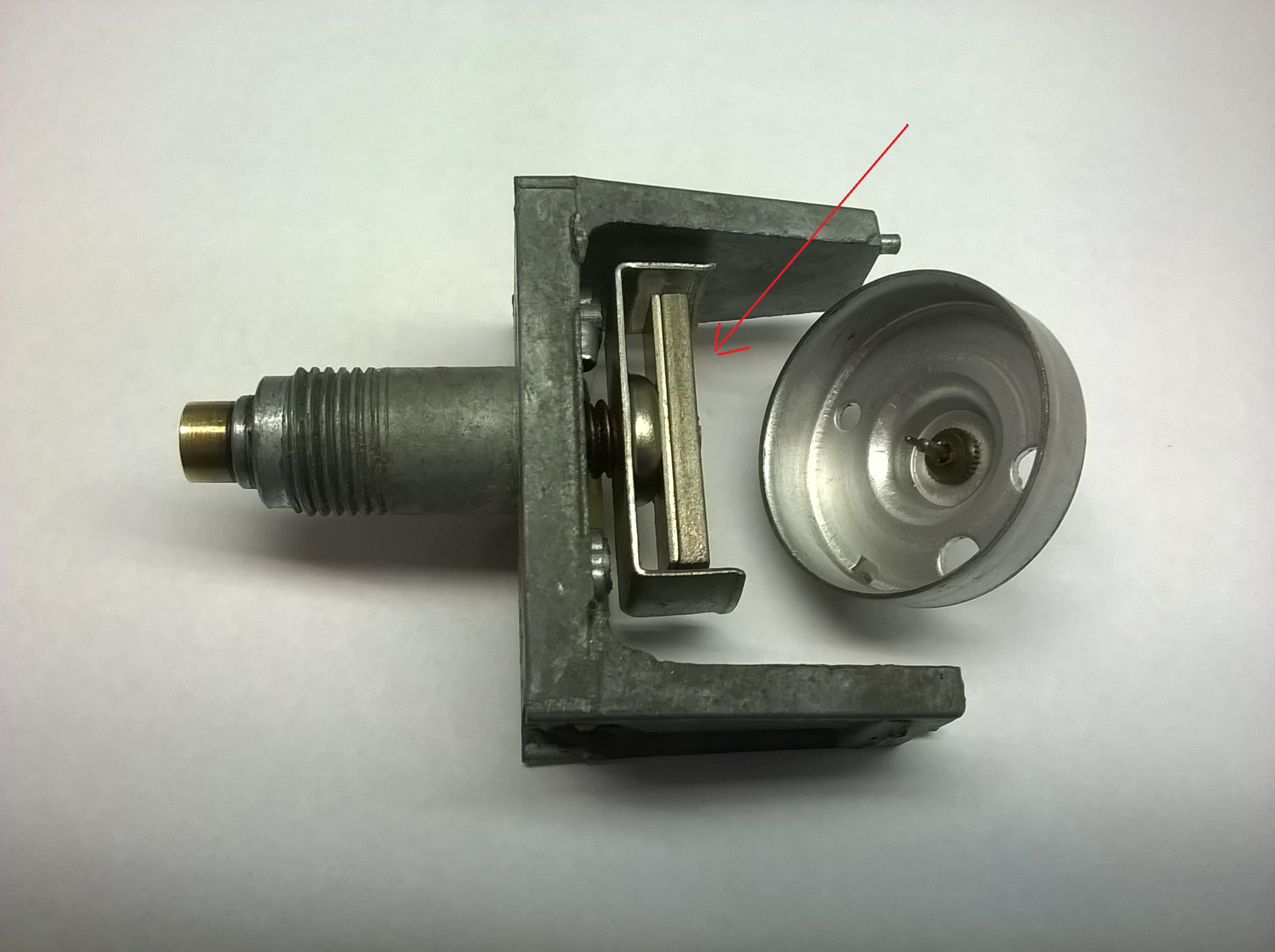

It looks like that fork has a magnet in it that holds th bell's center shaft
and that magnet seems pretty weak.
wow, i have never taken one apart like that. looks cool.
i guess you can get a magnet and cut to that size but it looks like the magnet spins and that messed up spring provides some measured resistance as it tightens which is equal to the rotational speed of the magnet, allowing the needle to point properly.

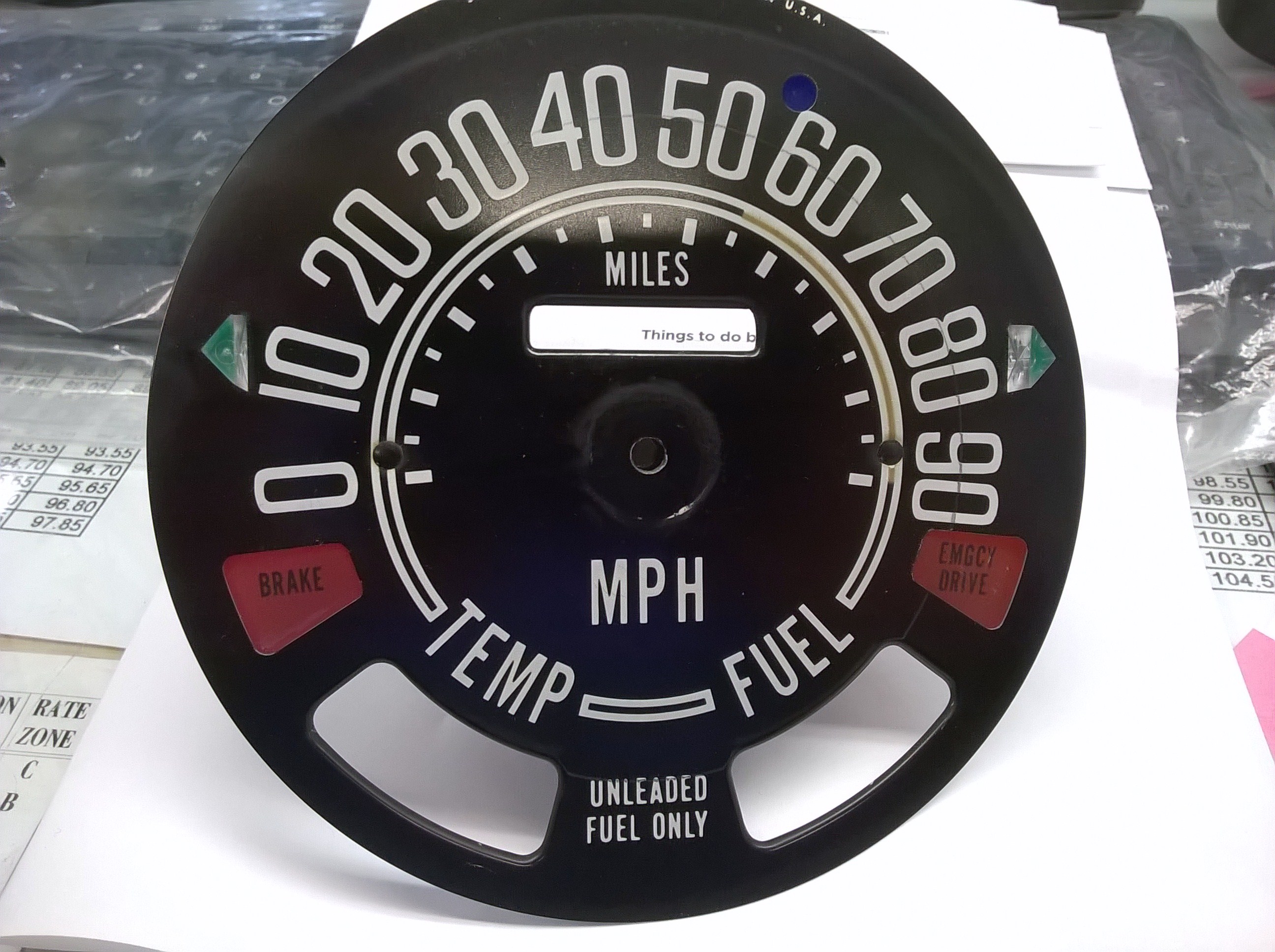

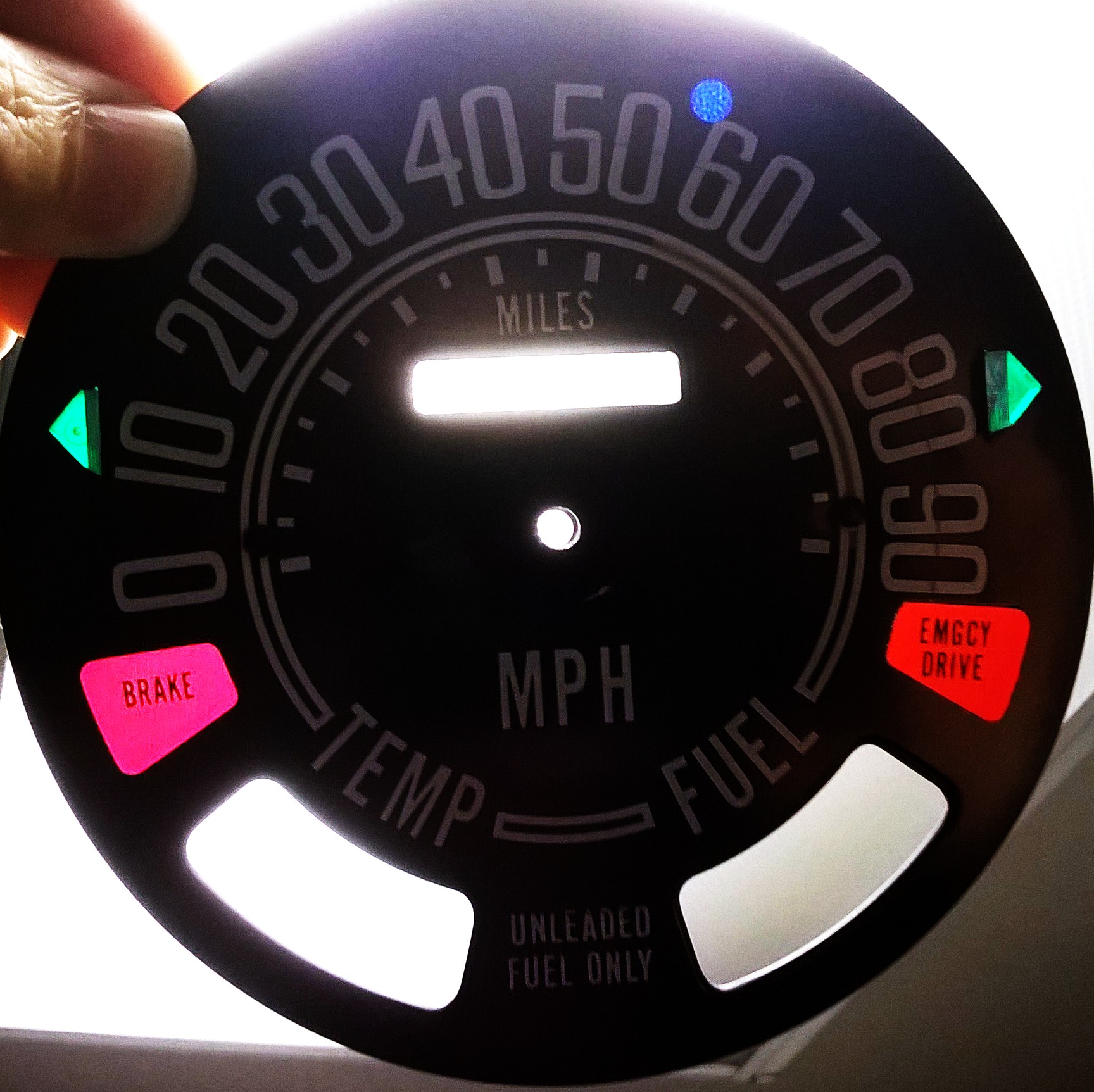

IF can get some funds together I may get a new Speedometer head. Does anyone know what year(s) this 90 mph brake light on the left came on?001.jpg
