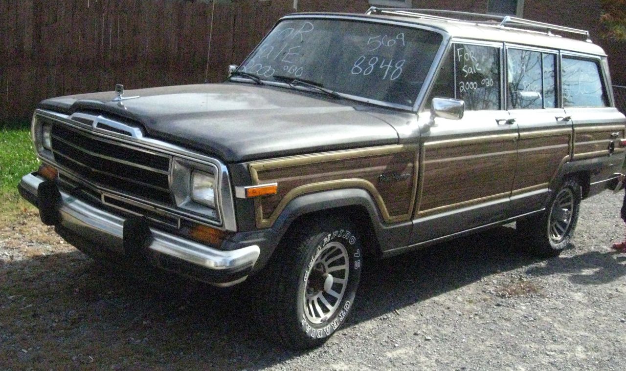

I bought an '89 Wagoneer today. It was stuck in 4wd and the seller said it would not shift out of first.
The tow truck driver lifted it by the rear and put it in neutral. About 1/2 mile from my house it started dripping smoking oil from the transmission case. The gear selector will no longer move out of neutral. Does anybody know what happened?

You said it was stuck in 4 wheel drive and I assume you meant the t-case. Then you said he put it in neutral again I'll assume the trans this time which means the t-case was still engaged and turning which will still turn the trans. Good chance both got smoked. Next time use a roll back.
Just because the rear was lifted.the front was still locked in an turning.which toasted it.same thing happen to my friends 78 jeep.toasted front axle an trans .up side is,its a jeep thing.tear it up,repair it,an break it again.repeat over an over.Still lovin ur jeep ;)
