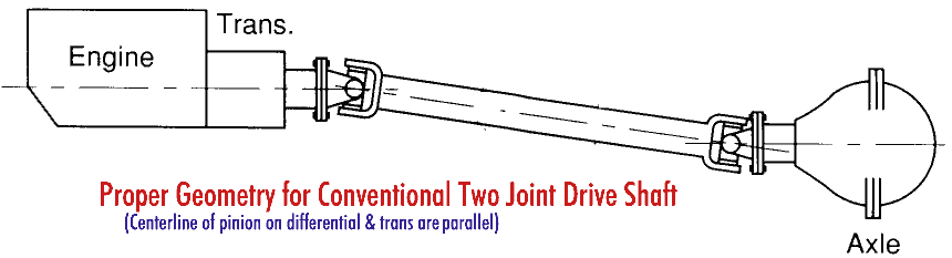

Hello, Ever since I installed the Dana 44 (Scout) in the rear of my CJ-7 I keep on blowing the slip yoke off! I've now tried traction bars and now broke the bolt on the traction bar and the slip Yoke off! My drive shaft angle is 30 degrees and my pion is straight with the drive shaft. So my Diff is tilted up allot could that be my problem?
I Am running big power over 500HP and red line is 7000RPM
Thks
