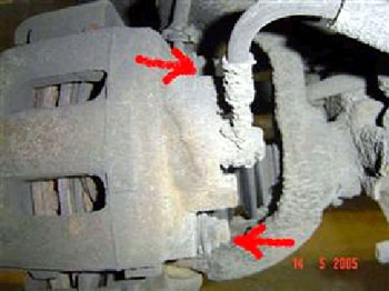

Do you mean that the caliper bolts are frozen:
Or are you referring to some other bolts? Post some photos if you can.

No, I'm referring to the bolts that hold the bracket that the caliper screws into. I have the caliper off and the bolts that slide are fine, but the bracket bolts are seized.
