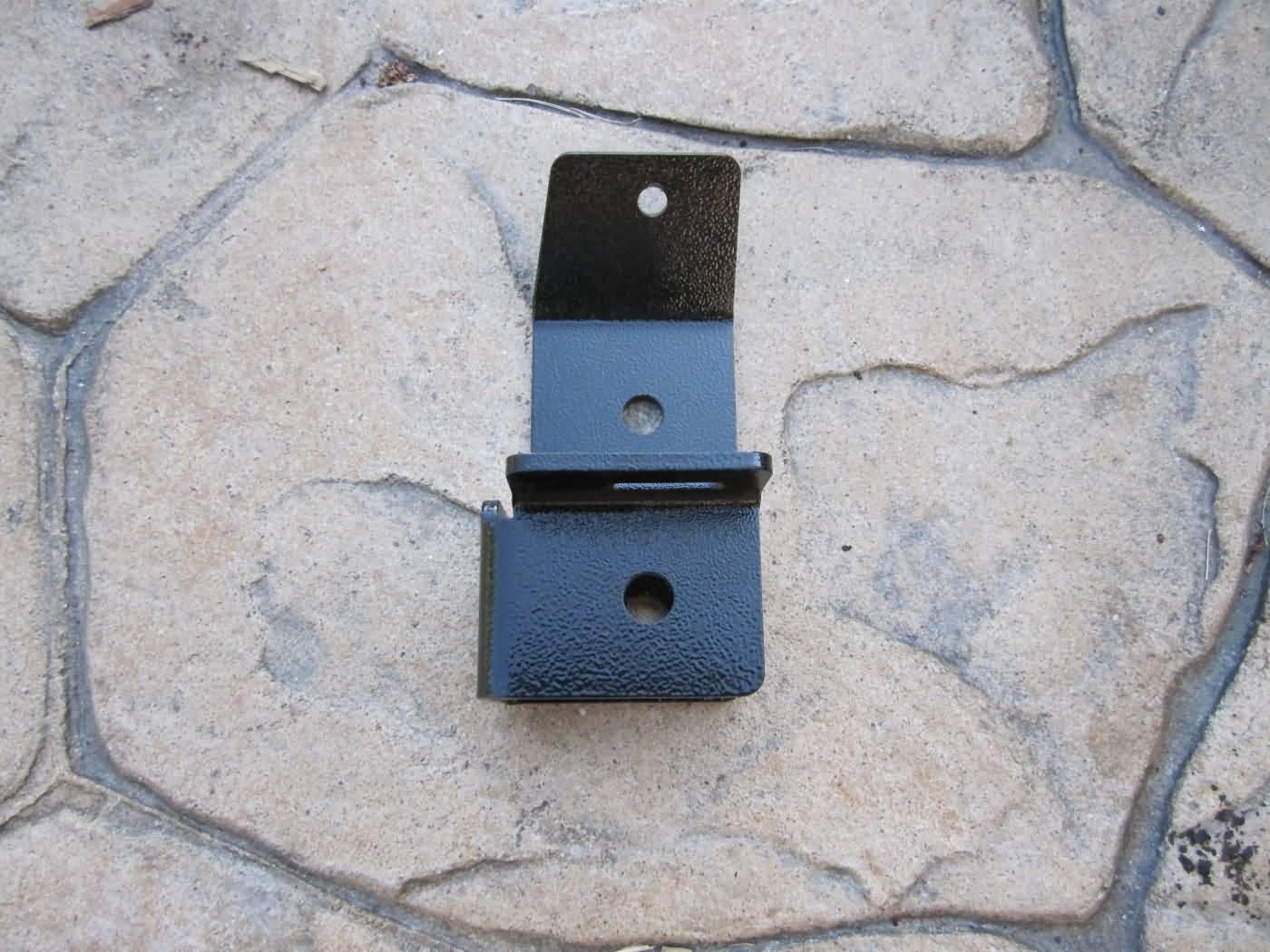

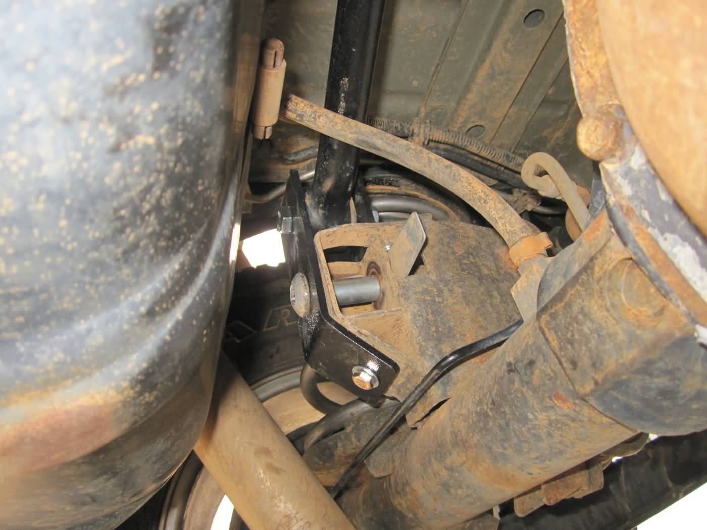

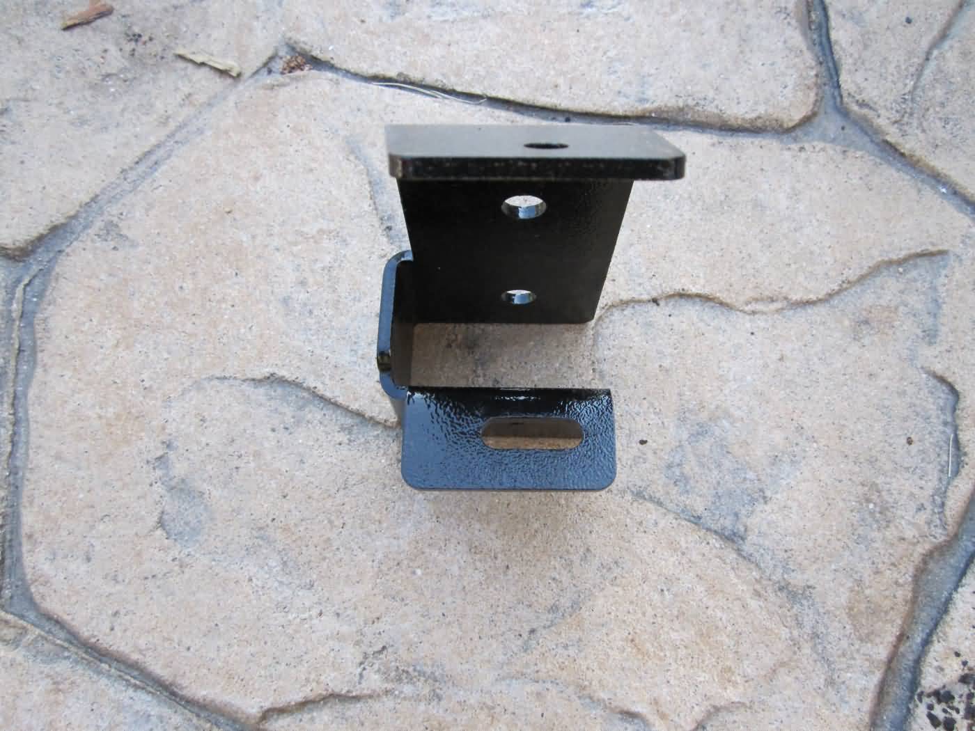

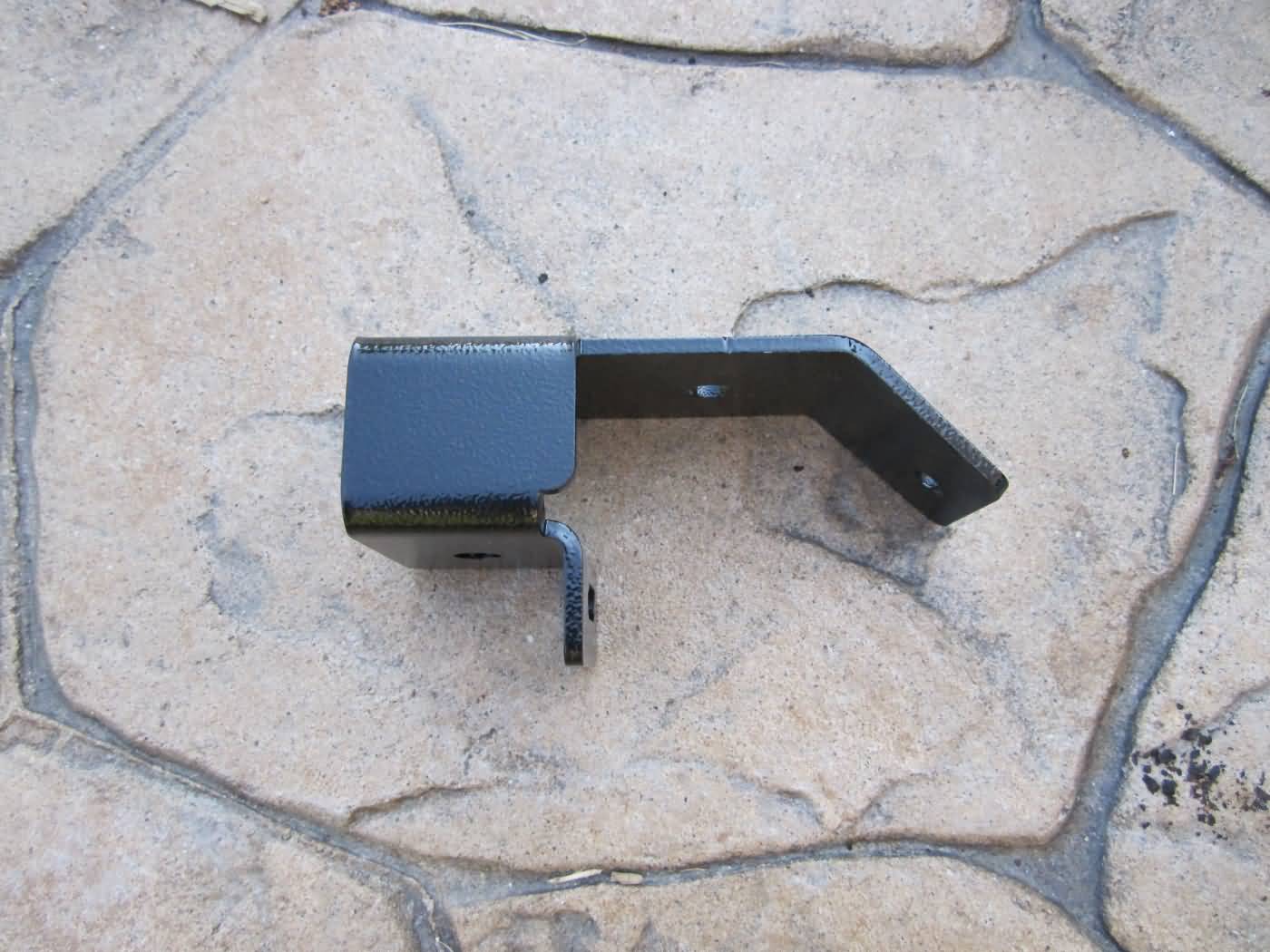

This is a Rough Country trackbar bracket that's designed to restore the correct angle of your trackbar. I've lifted my 2005 Wrangler 2.5 inches, but was still running the stock rear trackbar - what this did was compress the rear suspension, and pull my axle slightly to one side.
This is a simple and effective solution to that. It goes on fairly easily (read my install here) and is dirt cheap. It's not as good as replacing the trackbar with an adjustable one, but it is a fraction of the price.
