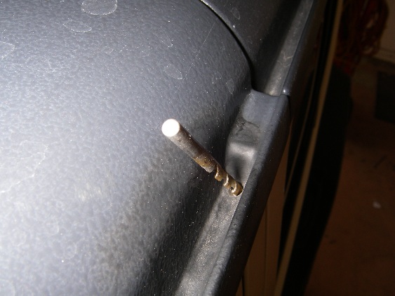

2) Drill a 1/8 hole on a angle by the lug to the rear of the T top in the rain channel. Drill it from the top side down.
This is the angle you will need to drill.

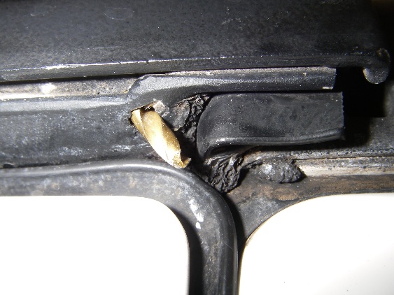

This is where the bit will come out.

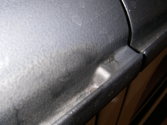

3) Clean the area and hit with paint on both sides so the white color will not show.
