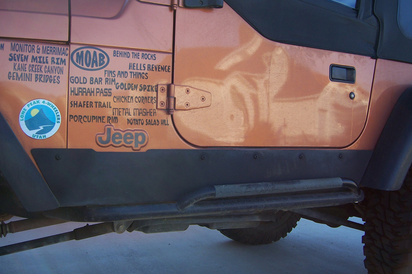

does anyone have any info on how to make your own rocker guards if anyone has made there own could you post a pic or give some tips and ideas here is a pic of the ones that i like

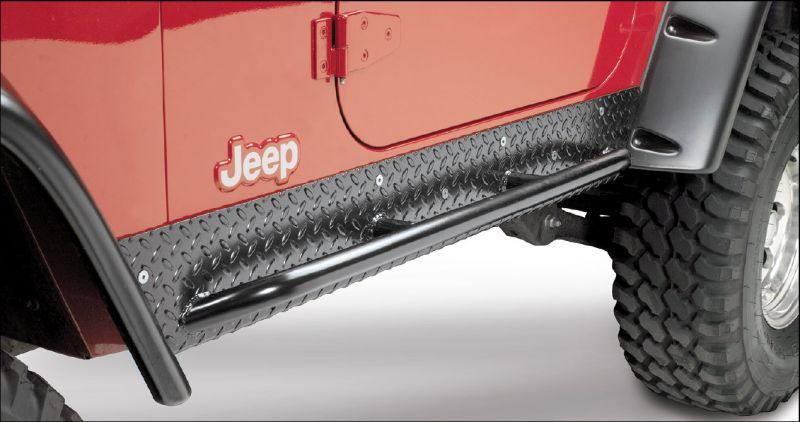

Personally I don't believe in putting your sliders on your rocker knockers due to the fact that they hit first and could bend the tub. I run them separate, allowing me to replace the rock slider when I hit and crush them, thus protecting the tub with the rocker knocker.
