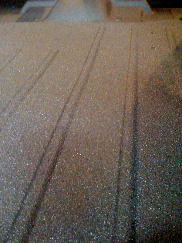

I had to bring this thread back to share my two cents worth:) I have been wanting to line my tub and have spent weeks doing research and finally settled on a product called Raptor by U-Pol. I heard good things about it, so I spent the $120 to try it. The kit comes with 4 bottles of liner, the hardener, and the spray gun. All you have to do is fill the bottles to the pre-marked lines, shake, and spray. It took forever to tape off the car but damn does it look good. The thickness can be adjusted with the air pressure and the kit came with more than enough for three coats. Not sure how it holds up long term but I would highly recommend this stuff. Even for an amateur like me it was way to easy to do... I attached a couple of iPhone pics to view!
Sorry, hit send before attaching pics! Here they are.
