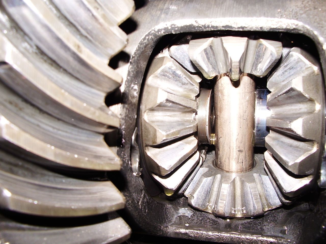

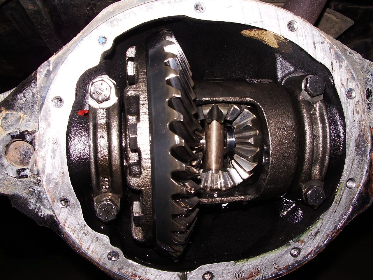

Well I took the Cover off the diff, the spider gears look fine to me?
There were NO chunks of metal, just some fine metal shavings at the bottom (very fine).
Here is a couple of pictures of the inside:

Transfering the gear oil to a container I found a small metal chunk that looks like it came from one of the teeth. I will be turing the diff soon and will tell you what I see.
I found broken teeth on the smaller of the Spider Gears.
