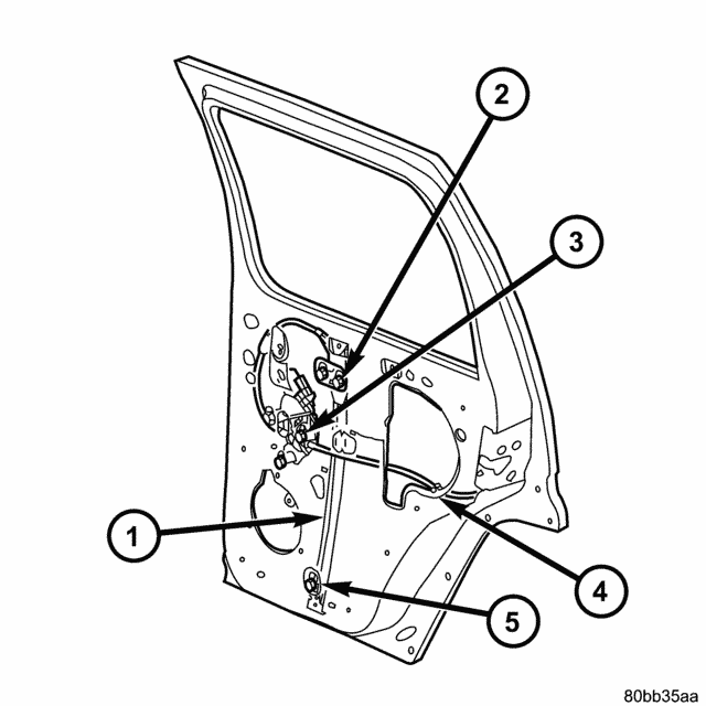

My wife's 2004 Liberty rear power driver side window was making a honking or groaning sound going up and down. Two days ago, it went down and did not come back up. The motor grunts going both directions. I manually pulled the window up thinking the motor would "catch up" but with the window in the up postition the motor still only grunts both directions. I was thinking a track or mechanism needed more grease, and now I have the door panel off but have no idea how the window moves up and down; therefore I don't know what to grease. Also, reading other posts regarding this situation, the problem sounds like it could be the "regulator clip." (I have no idea what that is either.) Any suggestions or location of a diagram of the mechanism would be greatly appreciated.

Unfortunately, the symptoms you've described is a faulty window regulator/motor assembly. The regulator is a cable actuated sytem driven by a motor. There is no fix to this other than replacing it. There has been a revision on the design of the regulator assembly. The old syle has a glass holder with one pop in plastic clip. The new style is a pin retainer mounted on the glass and inserts into the regulator bracket. IF you have the old style and a dealer can no longer aquire that same unit replacement, the glass and regulator would have to be replaced at the same time to correct this issue.
REMOVAL
  1. Remove the waterdam. Raise the glass and line up the lift plate clip with the hole in the door panel shown.
  2. Using a long flat blade or hook type tool, disengage the clip attaching glass retainer to regulator lift plate.
  3. Disconnect the glass from the regulator lift plate and re-install the clip.
  4. Secure the glass in the up position using a wood wedge, tape or equivalent.
  5. Remove the bolts.
  6. Disconnect the runout tube clip and remove the regulator.
  7. Disconnect the electrical connector
