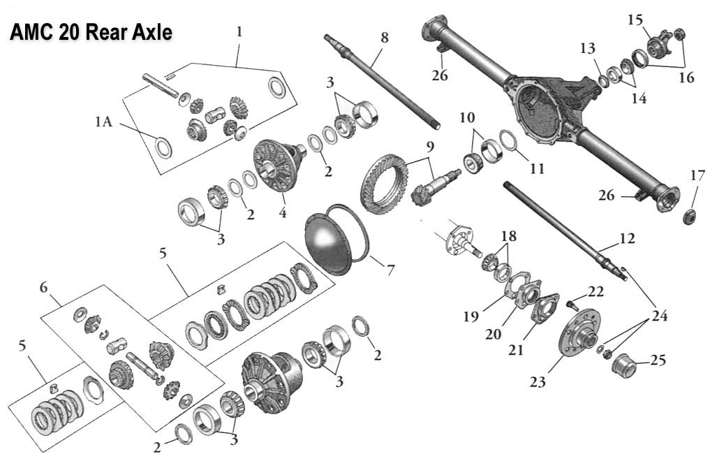

I sure hope it's not an AMC 20
I take it that these are not good to have, how can I tell. Like I said earlier, I am new to classic jeeps, my first one was an 05 so I never really had to do much other than general maintnance. This 81 is a different story, new valve cover, now new brakes and new rear axle bearings-- but this one is so much cooler than the 05.
The cover to an AMC 20 rear end will be round like a ball.
With a little upgrading this axle can be a strong as a dana 44. Install a set of one piece aftermarket axles and weld the axle tubes to the center cetion. You'll never break it unless you get into some hardcore wheeling with monster tires. Now might be a good time to upgrade.
I reckon I should've qualified, an AMC 20 with slighly bent axle tube on one side like mine was. I was so slight that visual inspection failed to reveal this was the problem. Spent 5 months, 2 axles and 4 bearing sets before I gave up and went with a rebuilt D44 w/locker. Only after pulling the 20 could we discern the issue.
