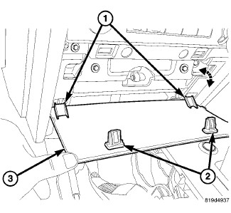

1.Using a trim stick C-4755 or equivalent, release the clips (2) and rotate the lower center trim (3) down and release the tabs (1).

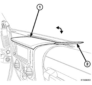

2.Using a trim stick C-4755 or equivalent (2), release the clips in the rear of the upper trim (1).

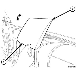

3.Rotate the upper trim (2) back and release the front (1).

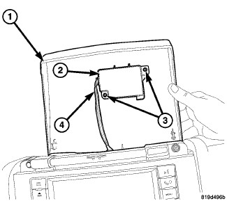

4.Disconnect the electrical connector (4) and remove the upper center cover (1).

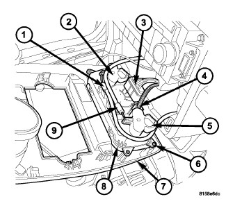

6.Disconnect the HVAC control cables (1 and 9) and disconnect the electrical connectors (3).

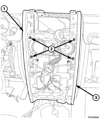

7.Remove the screws (2) and remove the center I/P trim panels (1 and 3).
