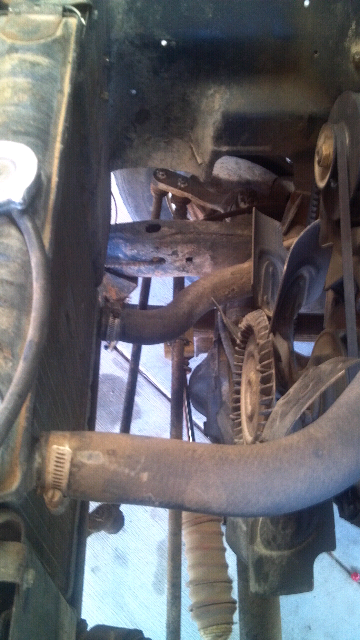

Hi i have a cj7 1981 4 cylinder engine.
To me the fan from radiator is a bit to far. Its about 5 inches from the fan and the engine hasabout temputure of 96F. . Do i need a spacer kit? Please help.
5 inchs
This is what my 4cyl tj shroud looks like the fan is near the edge of the shroud
If you have an overheating problem I would look into a fan shroud. You want the cooler air coming from the radiator vs. The outside air.
I take that back I guess looking online there pricey but cant seem to to find one for the 4 banger only the 6 cyl, id call the dealership

At this point finding an intact shroud for an 81 CJ7 might be impossible, you never know though. You might want to start investigating part re-manufactures like LMC truck and such for a reproduction piece. Or look into doing an E fan conversion.
also should have checked this before but 96 degrees celsius isn't bad either. both are well within normal limits
