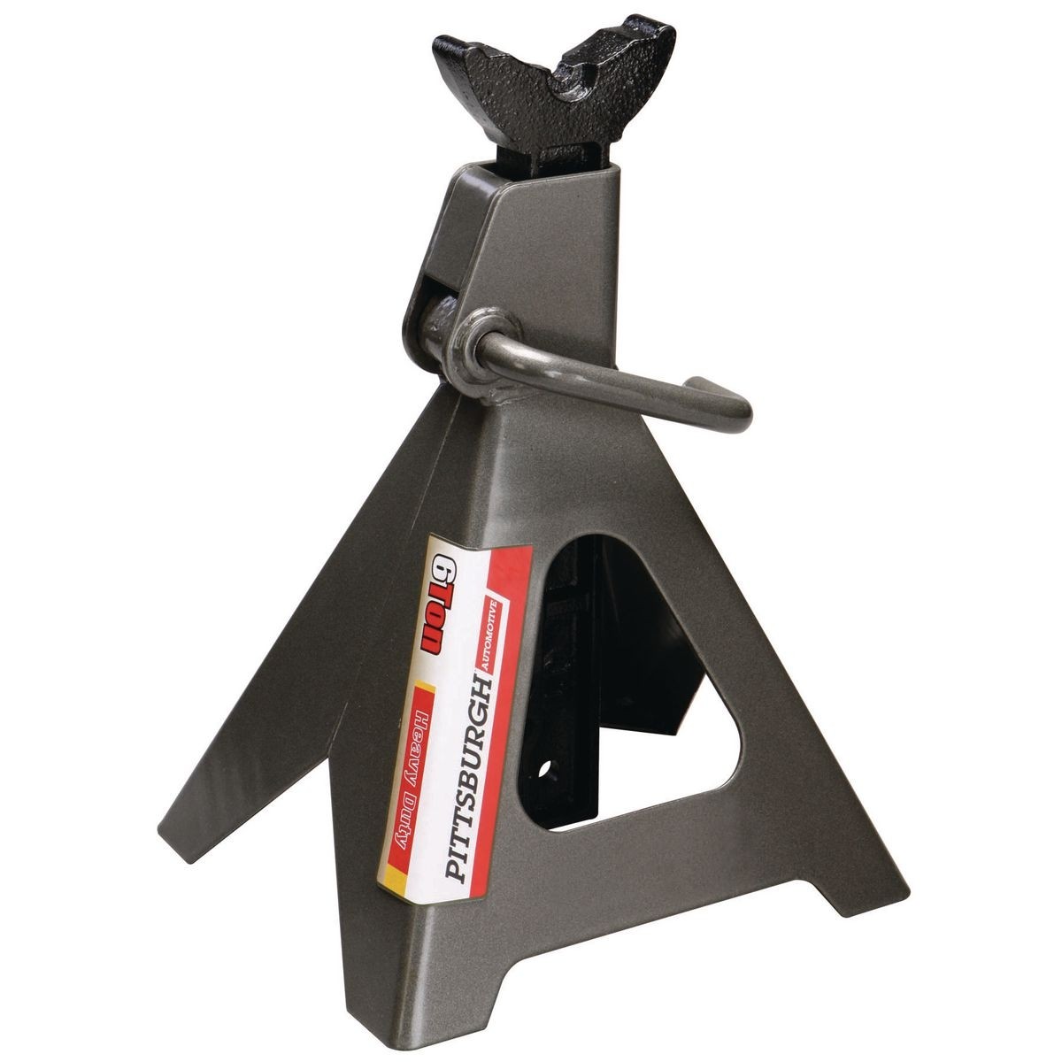

[FONT=&quot]Working under your vehicle can be a rewarding experience and jack stands should be major part of the tools needed to work safely under a vehicle. This is a PSA in case you own a pair of these HF 6-ton jack stands with part# 61197. Present a copy of the pdf to speed the reimbursement process.[/FONT]
[FONT=&quot]Description of Defect :[/FONT]
"For certain units, the ratchet teeth on the jack stand lifting extension post may inconsistently engage the pawl to a sufficient depth"

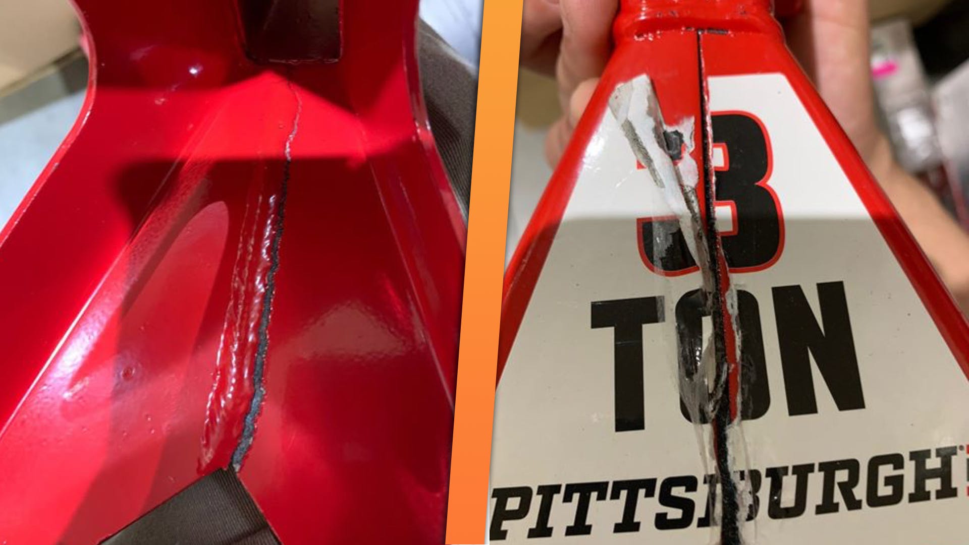

A few months ago, we recalled our Pittsburgh 3 ton and 6 ton steel jack stands (SKUs 56371, 61196 and 61197) due to a manufacturer's defect. We asked customers to return them and receive a gift card that could be used to purchase replacement jack stands. I felt terrible about that recall because you should never have a concern about the safety of any of our products.
Today, I feel even worse. I'm disappointed and embarrassed because we've identified a welding defect in a small number of the Pittsburgh 3 ton steel jack stands (SKU 56373) that replaced the recalled jack stands. We're now adding these jack stands to our recall. Unfortunately, this defect wasn't discovered during the initial recall investigation. If you own these jack stands or any of the jack stands in our original recall, whether or not you have had an issue with them, please stop using them immediately and bring them back to your local Harbor Freight Store for a full cash refund or store credit (see details here).
We have investigated all of our other Pittsburgh 3 ton steel jack stands (SKUs 56371, 56372 and 57308) as well as the Pittsburgh 6 ton steel jack stands (SKUs 56368, 56369 and 56370) and Pittsburgh 12 ton steel jack stands (SKUs 56374 and 56375) and did not find the defect. Although none of these other jack stands are being recalled, if you own any of them and have any concern whatsoever, please bring them back and we'll give you a full cash refund or store credit for those as well.

Commendable that HF is taking steps to take care of the problem but I don't think HF is the only company with imported jack stands of questionable quality. Got a $60 store credit for two pairs of non-recalled orange 3-ton and grey 6-ton jack stands. No questions asked after I showed them ERIC's latest email. Looking at ESCO brand of jack stands that utilize a pin to ensure better security while working under a vehicle.
