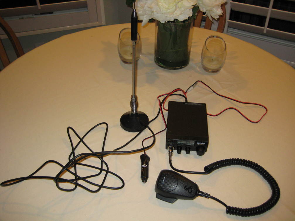

Here's my portable CB setup - It's a cheapo cobra CB, a magnet mount antenna, and a cigarette adapter plug. Anyone done something similar?
It works great, but I haven't found a good place to mount the CB (on a temporary basis) - I just put it in the console and leave the top open.

Hey i dont have an answer for you, but I was just wondering where you picked up your antenna? Im gonna get my cb from wally world, but they dont sell antennas, and the only ones i can find are a bit out of my price range lol.
it's a walmart antenna, walmart cb, and I got the cigarette adapter at Pep Boys. Pepboys actually had alot of CB stuff, so you may try there.
I like it because it's got a strong magnet base.
When did you get your antenna? Cause I dont thing walmart carries cb antennas anymore? And lol unfortunately where I live we dont believe in pep boys aparently cause we dont have any.
Radio shack sells antennas. I found this out after I spent double the amount at Academy. I was admiring another dudes Jeep last month and noticed he had a cb in his cab, but there was no main unit, it was all built into the mic/handset. I thought that was cool but havn't looked for it on the net yet.

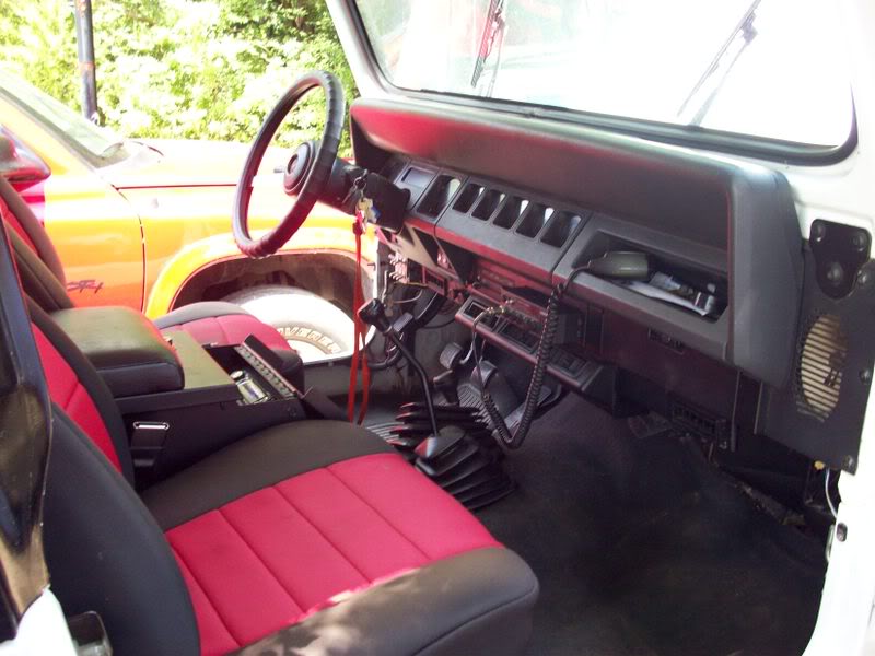

In the old jeep I had the 12volt adapter so I could pull the cb in and out but with this one I put the cd player in the center console and after slight trimming put the cb into the dash. Slight as in I could put my radio back into the dash and you can't tell. I love this cb though, it sounds clean and has a front mounted speaker so it's really easy to hear.
