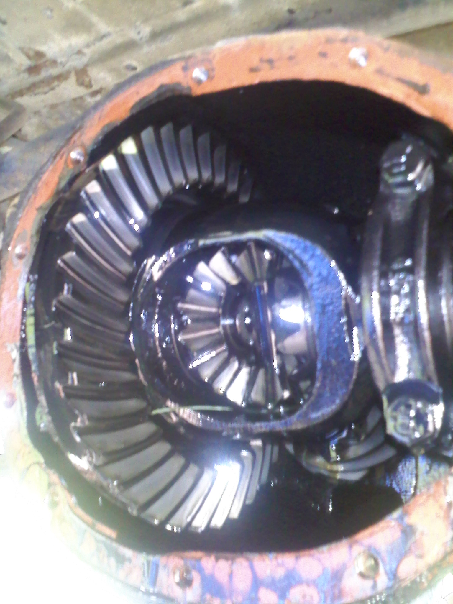

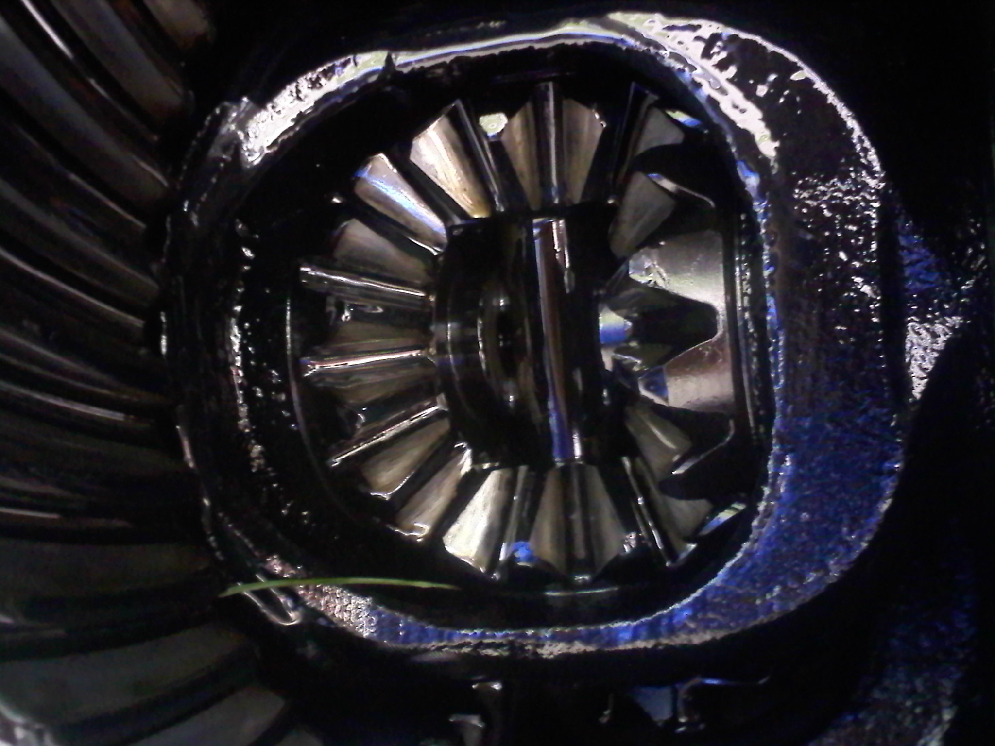

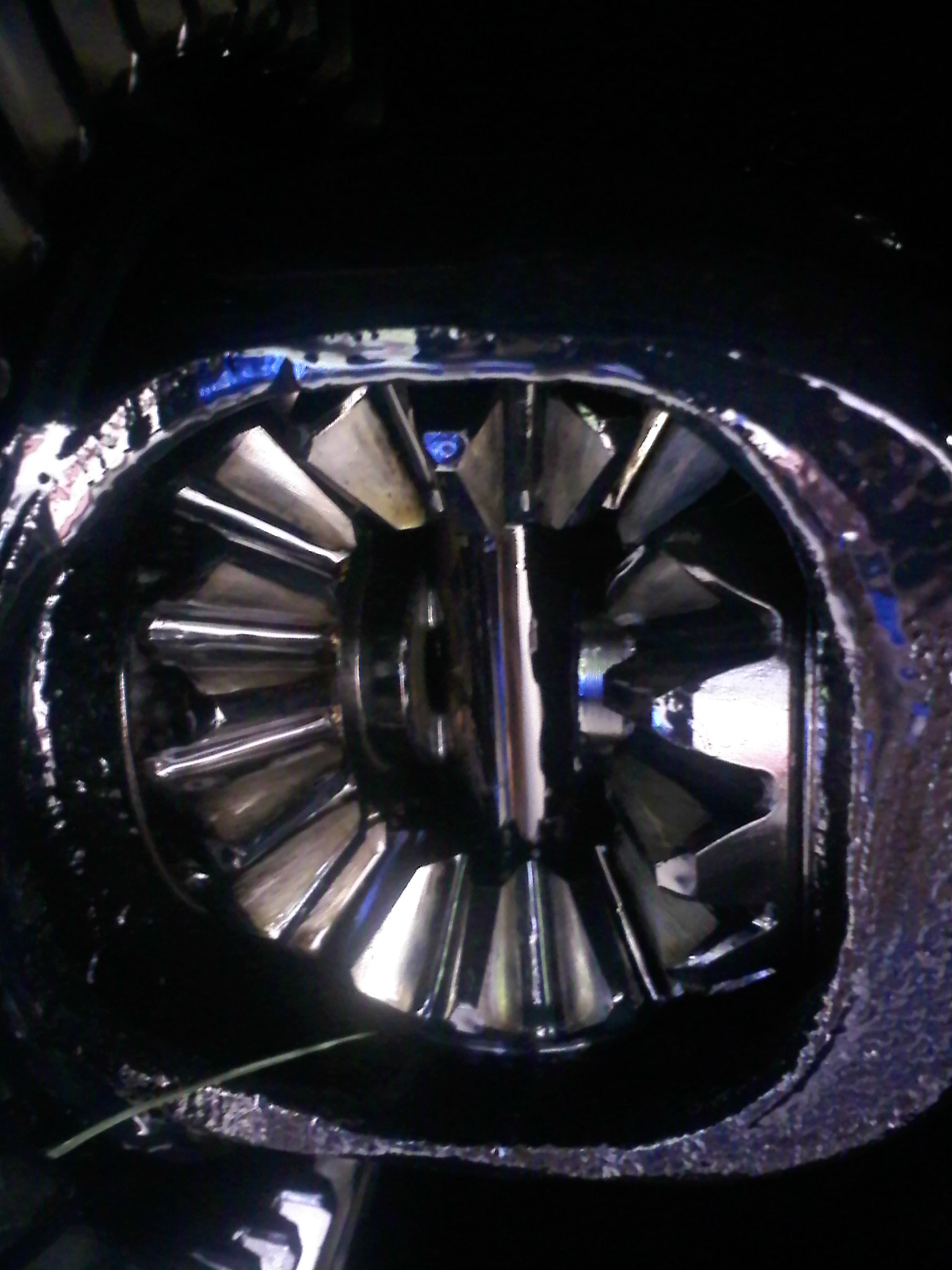

alright i took off the case and inspected everything that i could. for the life of me i cant find anything that looks broken or really worn. i took some pictures to see if my definition of too worn isnt too far off. From what i saw when i drained the fluid i didnt see any metal or anything like that.

MMMmm, that answers that. From the pics , it looks good. I would double check the pinion gear and pinion endplay before you put it back together.. If those 2 checks out good, i'd move on to the t.case.. Those worn gears you found in the T.case needs to be replaced prior to re-evaluating for the popping noise. Theorethically, with the output torque from the transmission, its possible that the gears are skipping if the gears are that too far worn down.
