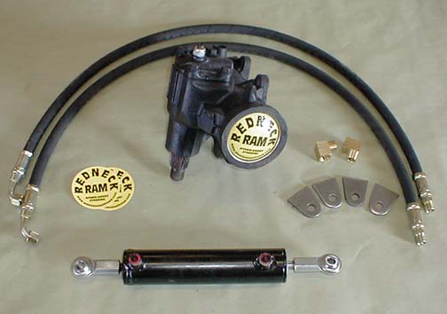

Stearing box! But I would have to look at it, U-joint most likely won't pop when not moving, and they are more of a clicking sound! Pitman arm, if it is broken, you simply have no steering, and tie rod ends.... posibility I guess, grease the heck out of them, if it goes away for a short time, then that is it, but my first guess would be your steering box. Mine does it too, and has for quite a while, I am simply gonna upgrade to a red-neck ram steering. (it's hydrolic, but I am waiting to get my D44 in)
$450, about $150 more than a stock replacement.... money well worth it!

The Redneck setup won't cause any trouble on the road. It's a hydraulic assist, you still have the mechanical link from the Steering wheel to the box to the axle. The ram just makes it easier to turn the wheels. It's not needed unless you are running large tires and/or doing alot of slow speed stuff. The junkyard has lots of cheap replacement steering boxes if yours is shot.
