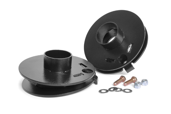

Are you trying to adjust the pinion angle just to bring your springs back to vertical? If so, something like this may help:
Jeep Accessories - Rear Coil Correction Plates
If you buy them be sure to ask for the Jeepz.com discount.
As to your question, assuming you are adjusting the upper control arms, then yes - making any adjustments in your arm length should change the pinion angle. I don't have enough experience to tell you at what point you'll encounter problems though.
