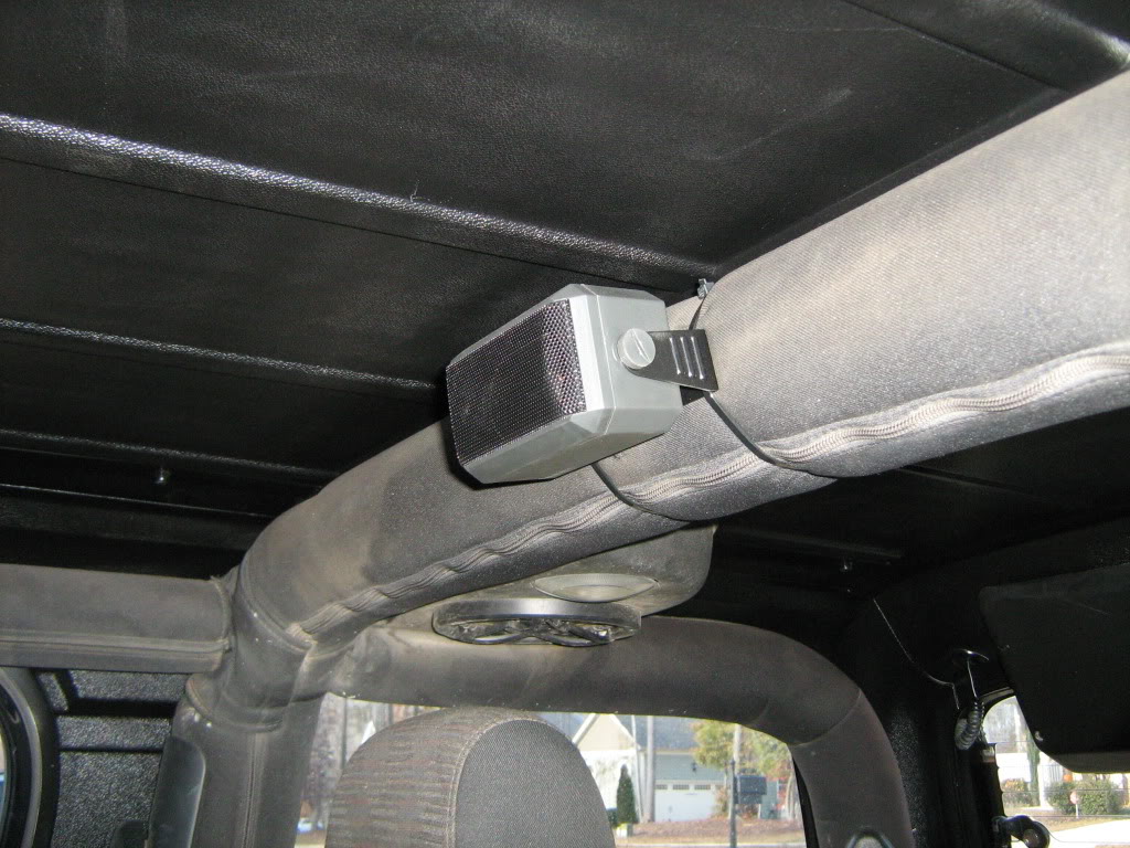

I used Rustoleum enamel primer and paint on mine ( on the outside ). It's held up well, I rolled it it on with a small foam roller. I'm going to do the inside in a week or two. The primer is a very light grey, almost white. I may just prime the inside and leave it that way.
WOW, that really came out good. What an improvement over the white. It really gives the interior a finished look. This is definitely something that I will have to do.
