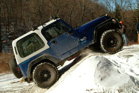

I have heard from other posts that if you do the heat gun thing, the color comes back for a while then fades again, and cause some of the oil is removed, the flare loose a little flexability. I have TJ flares on my YJ, but they are the sahara units and are painted so they probably won't fade. That would be another route is to find a set of sahara flares on ebay. got mine for $150 for all of the flares and steps, just used the flares and re sold the steps and junk. they turned out wicked nice
They are kinda dirty, but look wicked killer in the sun.
