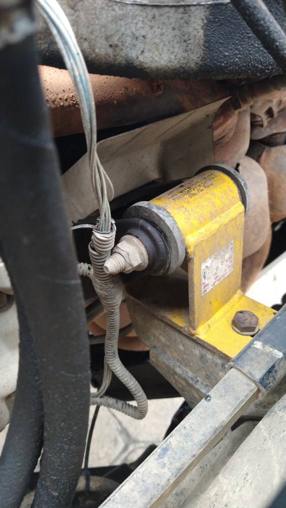

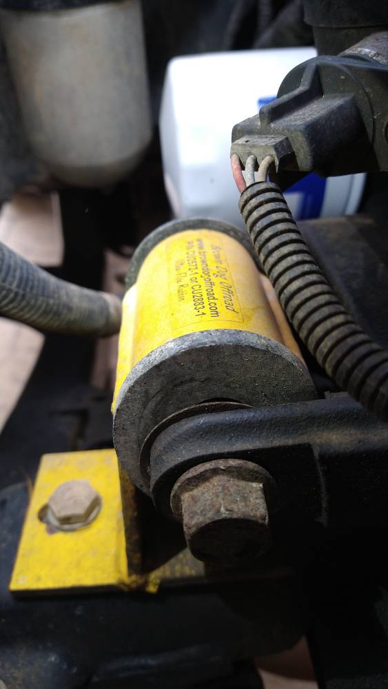

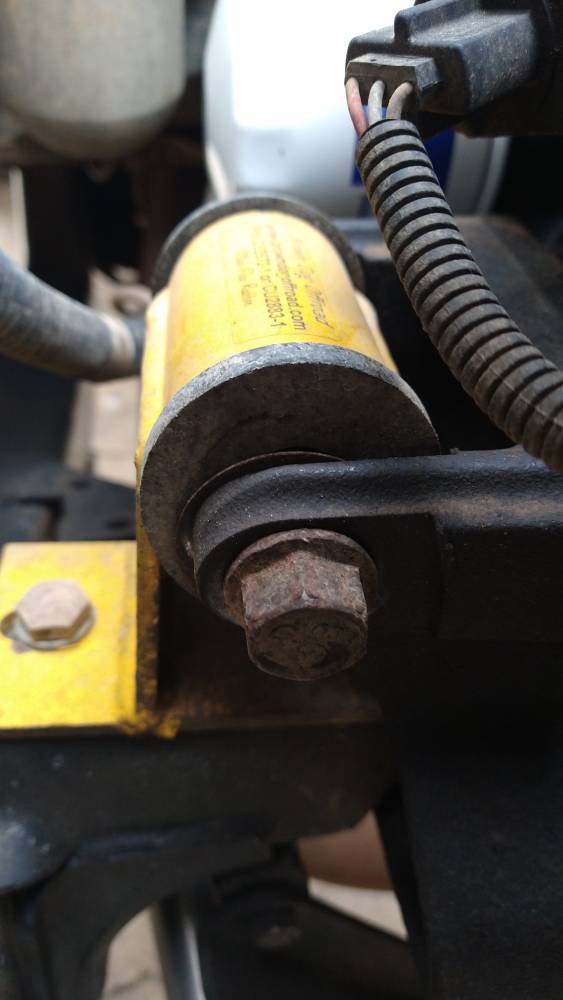

Jeep sounded pretty nasty, and it kept getting worse. I eventually noticed that the fan was making contact with the plastic shroud. I spent some time planning out how to lower the shroud, before I finally thought "why did the fan move"? It turns out that my 11 year old engine mounts had finally given out. About $35 later, I've got new rubber bushings for my Brown Dog mounts, and I'm back in business.

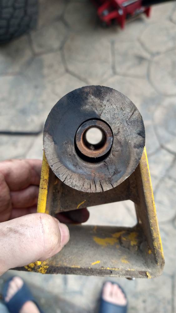

A bit hard to notice how worn out they are while in the Jeep, but easy to tell once removed. The passenger side was much worse than the drivers.

man, those mounts are sagging bad. imagine if you had the stock mounts in, that engine would have been banging the oil filter on stuff
You're right. I've got a 1.5 inch body lift, with a 2" motor mount lift. There's not much distance between the bottom of the fan and the shroud.
