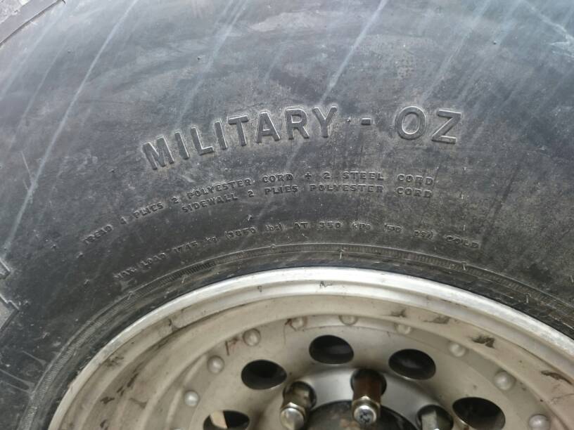

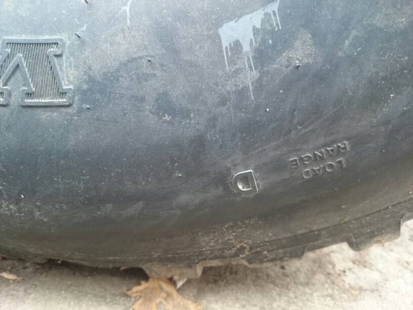

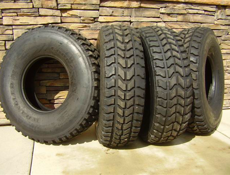

Here is what I'm using D rated. Maybe 8 or 9 ply. I'll check my tires tomorrow to see. I've seen these for 500 bucks or so with 90%tread for 4 tires . Mine were 90-95% tread 600 four all 4 shipped to my door. I installed them on the rims myself. 74eb1b_20facf1ffd052ee39e732f17de39cc83.png

Load range D, 8 ply and puncture resistant side wall. 3850 lbs at 50 psi. I'm running mine around 28-25 psi front and rear. Wear seems good, can't beat the the price. I mounted mine on 10 inch wide rims. A little wider rim will allow more air pressure and better wear on road but they get stiff with more air. I'm using beads inside the tires for balancing, I would go with wieghts. A lot of people don't have much luck with the beads, so I've read. They are definitely a stable ride. They do do not walk or wallow side to side like my previous Dunlop 35" did. That is important when you driving down the freeway. I used my jeep to a 24 ft outlaw boat for 3 years. I towed at 70 mph with just a few more lbs of air. It never wandered while towing. I like the tires, on road safety is a big concern with me
