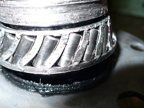

I have started to insxle xlqtall a new Crown one piece axle in my AMC 20 wide track. The kit has Timkens bearings and the inner race is .035 different than the outer race. The way the bearing is to be installed will position the inner race out past the axle housing flange that .035. The instructions state to test fit the spacer and bearing in the housing and grind the spacer if needed. I have done that and now have the bearing test fitted in the housing and set at .050. The instructions say that it should be no less than .020 and no more than .060. Am I doing this right ? Before I have the bearing seated on the new axle I want to make sure it is going to work right.
