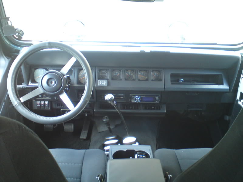

Here's where I placed mine:
Main unit replaced:

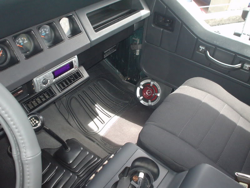

Front speakers in mod pods under the doors:

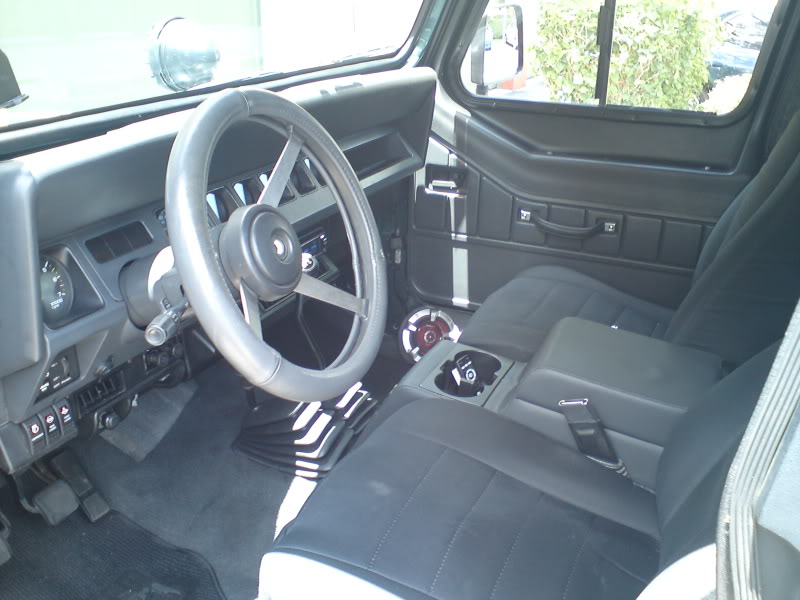

This one I took BEFORE I drowned my first head unit, so imagine the mod pods with the main unit above...

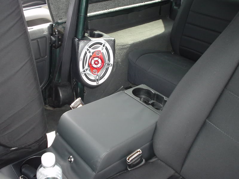

Rear Speakers in wedges (6X9):

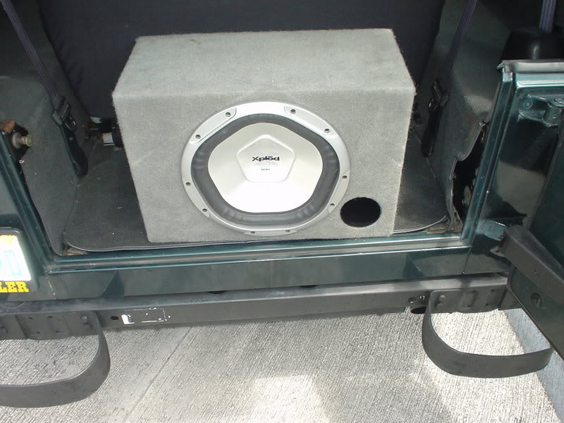

Subwoofer on the back (amp is in a fabric covered wooden frame under the driver's seat):

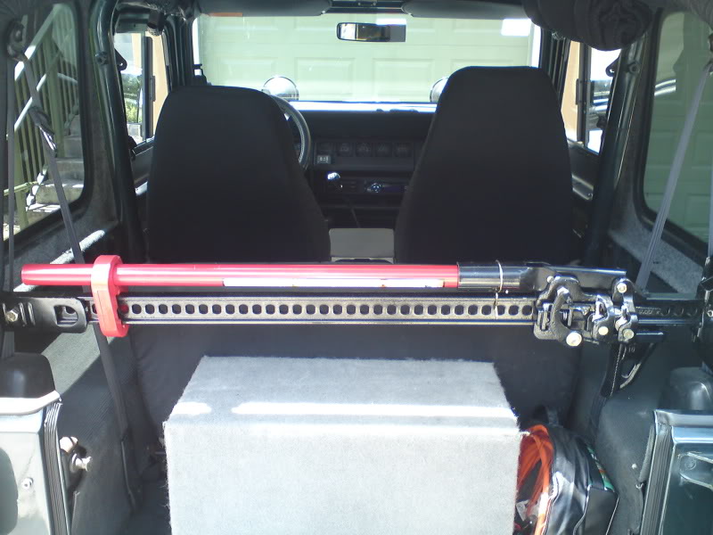

Here's the SW turned around so that you can see the driver...

I like the speakers mounted behind the front seats like that. Where can I get those enclosures?

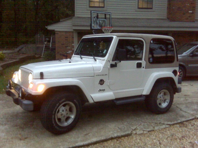

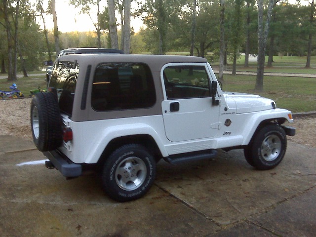

Forgot to add some pics. Again, quick shots with the phone, but it's clean now.
QUOTE]
You can buy them from Quadratec or Crutchfields.

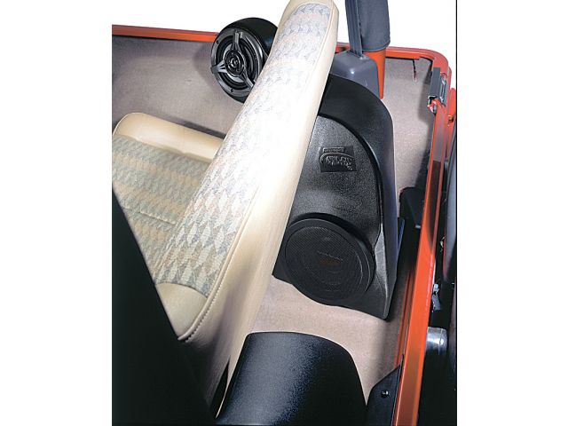

The Quad Pods are also kinda cool:
Select Increments 60402S - Select Increments Quad-Pod with Speakers for 76-06 Jeep® CJ-7, Wrangler YJ, TJ & Unlimited - Quadratec
Personally, if I had to do it over again, I would go exactly the same route I went; kick boxes under the doors with 4-way polypropilane spekaers to resist water and dirt, wedges with 4 way polypropilane speakers on the rear, aluminum sub (I like the sound taste; a polypropylane or any type of plastic one would be just as durable, but sound taste would change, so it is a matter of personal taste which way you go), and the amp under the driver seat in an easily removable mount to keep it away from the floor (I take out 3 screws and discunnect 4 cables, and the amp and SW come out for wheeling; for LIGHT wheeling with no water damage lurking on the horizon, I can leave the amp and SW in and even if some water does get it, it will not kill the amp).
Of course, in my case, the entire system was free or close to it (the amp was $16 and the SW $21; the rest was free), so very little investment, and whole lotta BOOM BOOM!!!
I thought about adding 2 additional speakers (for a total of 6) for the sound bar, but they would basically ad as tweeters, and I can get the same effect by just using the DSO function of the Sony head unit.
The quad-pods are nice, but I still feel they lack a bit of volume to maximize the sound, and 8" subs are a bit smallish if you want deep base (one 12" sub will put out more bass than 2 8" subs). You could overcome the volume part with Fiber Fill, but they typically never bring enough material to make any real difference, so you would need to get more. I also dont see any ducting in these, which means the bass sound taste is different (and how good would depend on how rigid these things are; Typically, plastic enclosers are not rigid enough, especially for enclosed cabinets, and the sound suffers as a result, even more so in the case of subwoofers. Of course, since it is a Jeep we are talking about, it should be good enough.
But the space you will save is not so much compared to what I currently run (it WOULD make it harder to steal the subs, but also harder to remove them for wheeling).
I do like the fact that they are more out of the way than the traditional wedge, as my wedges interfere with sliding the driver seat all the way back (not to mention my console gets in the way of folding the seat all the way forward!). But the down side is that you need to go back to smaller speakers for the rear. It's all a tradeoff... but I would still go the way I went
