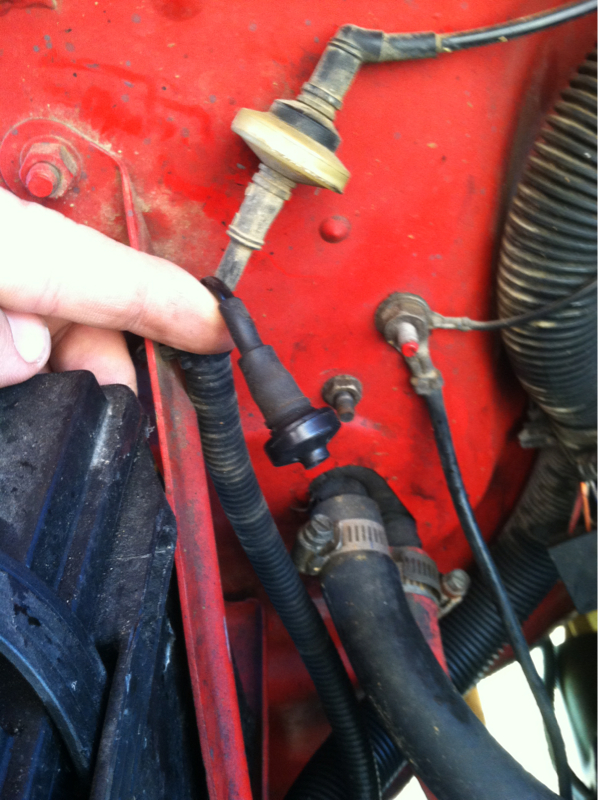

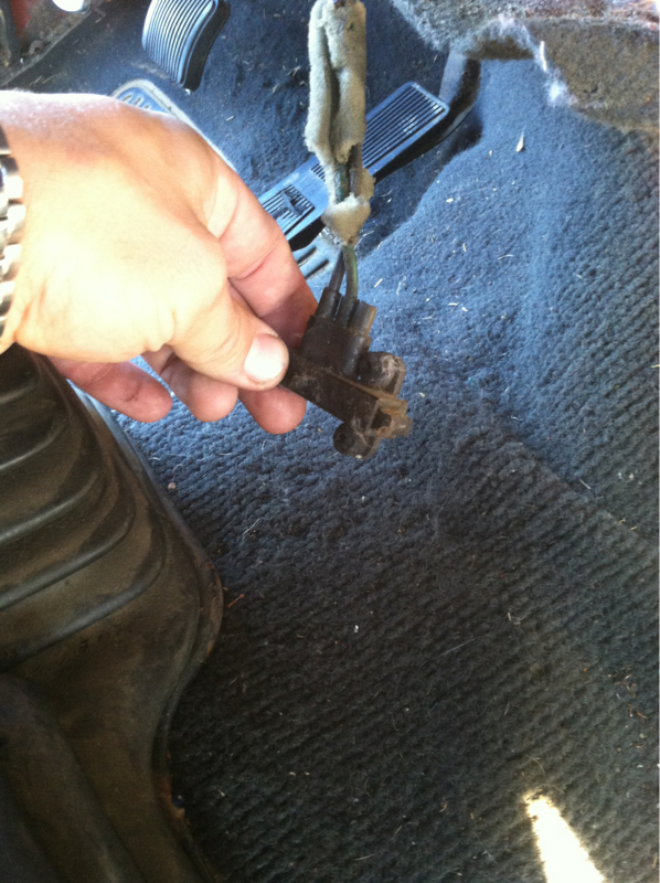

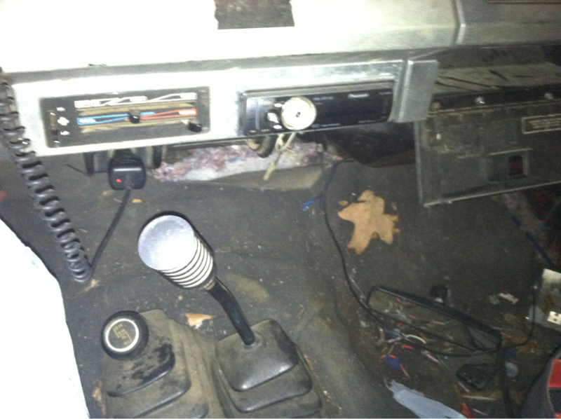

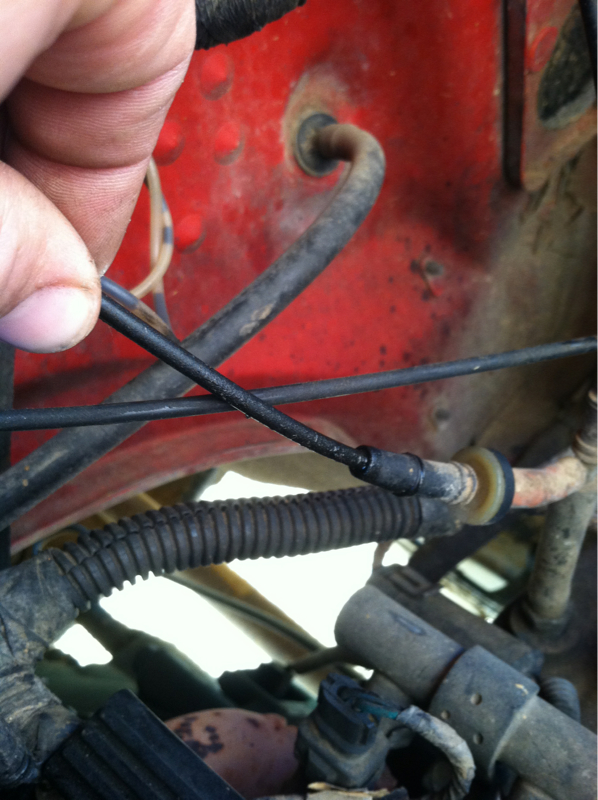

First picture is the vac line near the battery. In that same bundle two go to front axel and four go to the back of the transmission but that one just goes no where. Second picture is the vac "switch" that I think mounts behind the climate controls that had three ports one black line that you see in the third picture and the green line which I can't find where it goes or comes out because it goes behind the dash and that's as far as I've gotten with it. The third port is empty but when the button is pushed it sucks air. Maybe it doesn't need a line but hopefully your more experienced people can help me out thanks

Air door motor switch is the thing hanging out from under the dash I finally figured that out but what about it only having two lines running to it?

The first pic, the vacuum line by the battery, is simply a vent for the vacuum system and it doesn't go anywhere. The 4 vacuum lines that go back to the transfer case are: Vent, Vacuum from intake, and 2 lines to switch the front axle disconnect.
Thanks I was thinking that's all it was due to the fact vacuum line wouldn't even connect to that vent but wanted to be sure. Yeah I don't expect to be racing in the old 4 banger but barely getting 60 downhill just doesn't seem right. I replaced a few vacuum lines that were old and brittle not sure they were bad but the joints and elbows were rotten for sure and I have done a full tune up so I disconnected battery yesterday thinking maybe resetting it might help and not sure if it was my imagination or if it helped but it seemed to and doesn't smell like gas as much but that's probably just in my head. Does anyway know about that third vacuum port on the air door motor switch? Is it supposed to be blank or is it supposed to have a hose going somewhere? Chilton doesn't really say anything about it just showed a picture of it with a name but no lines going to it just said to disconnect them. I got a great deal on this jeep and all together it's a good running jeep just needed a lot of little odds and ends. Only has 130k miles ill post some before pictures and some of where I have her at now se is a work in progress.

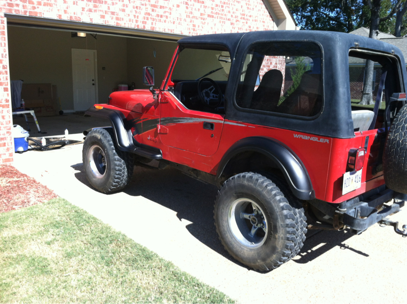

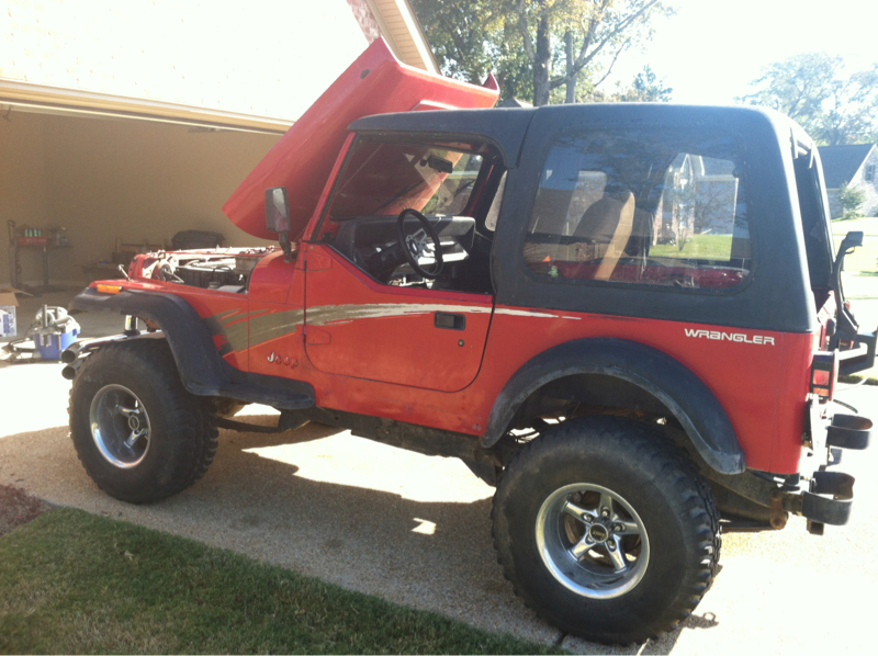

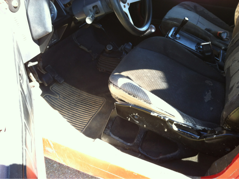

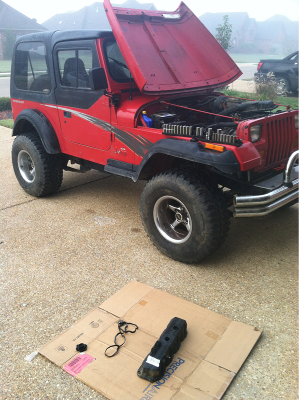

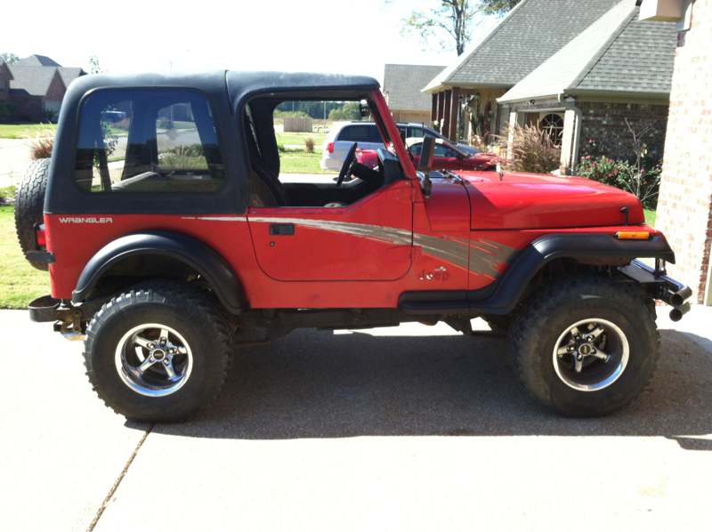

Progress so far still have a long way to go. Working on a plexi back windshield and recoating the top. Seat covers are soon to be at the top of the list does anyone have any reviews or opinions on seat covers?
