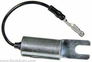

I upgraded with the "juice box" coil, the instructions didn't call for reusing this part but I recently added a wire from the + side of the coil to a part called a ignition capacitor( i included a pic) and reconnected it to the old coil bracket . so far I've had no stalls, but i have herd of the ballast resister I'm just not sure what that is, can anybody tell me if a ignition capacitor and a ballast resister are the same thing?
They are definitely not. A capacitor is basically two metal plates close together that store charge. It can dampen variations in current and do many other things. A resistor simply resists current flow, so that at a given voltage a circuit will pass less current.

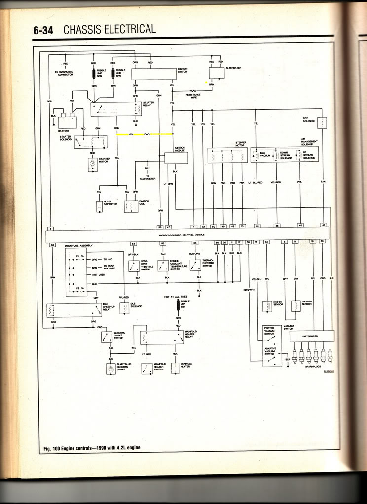

The resistance wire in question, is in place on all 87-90 YJ's
It's highlighted in yellow on this diagram & lives inside the big harness loom going across the back firewall of the engine bay. It may or may not say "do not cut" on the insulation, but it should look different from the rest of the wires in there.

The thing is, the CJ needs the wire from Napa as it wasn't in the CJ harness. Once I went through many E-conversations I was able to understand the schematic I posted in this thread. I highlighted the wire with yellow & mbalbritton agreed it was the one. That wire appears in the chilton's drawings for all 4.2L 87-90 YJ's

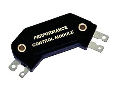

At this point I realize the ignition module is going out, so i''ve decided to replace it with a gm 4 pin module from summit ( proform, proformence control mod.http://www.summittruck.com/parts/PRO-66944C/.) Ive read all about how to do the install ,but my question is? will the gm module work for my 89 yj ? The instructions on the junkyard genius didn't give a vehicle specific year that his moods will work for? also would it hurt anything if i hooked a diode up to the white wire just in case,or can i disconnect it and not use it?I have the ford tfi upgraded coil,cap ,and roter .Now i just need a module that can handle the tfi upgrade.Junk Yard Genius.com 'Stealth HEI Page

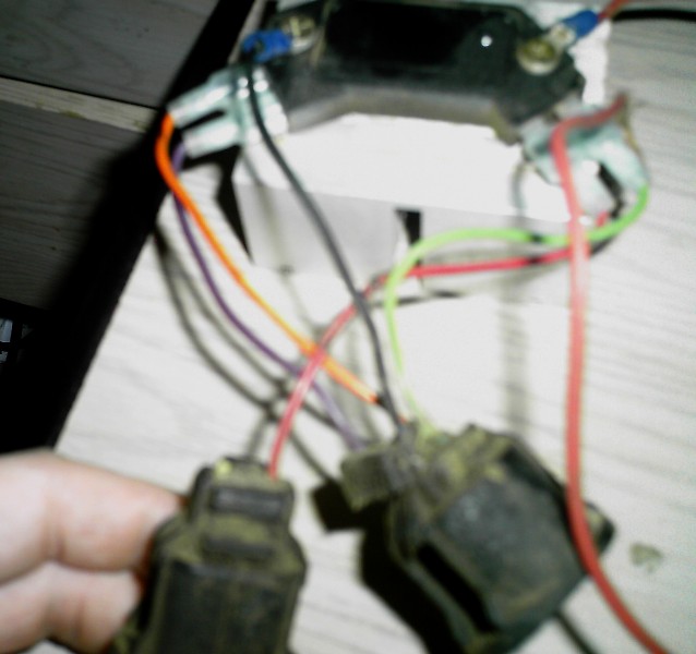

You don't use the white wire, just cap it off so it isn't exposed. I've attached 2 pics of my setup. Where I've screwed the module to the heatsink the black wire is from the duraspark plug, the red wire is a ground wire I've attached to the firewall, yeah its red, yeah its a ground. The white wire I cut off completely you do not need it. This mod is good for ANY year that uses a Duraspark ignition module.

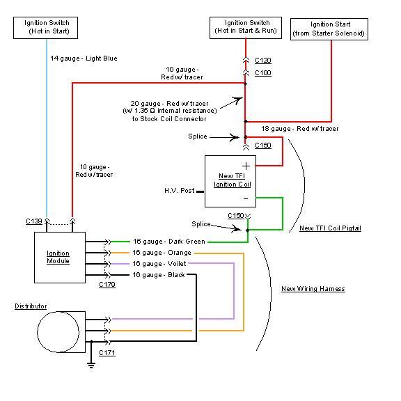

I finely finished replacing my dura spark module with a gm ignition module , i used accels performance module. I was going over a wiring diagram that I got when I did the TFI upgrade and I noticed that the + side of the coil was replaced with a 10 gauge wire. So I fugered it could'nt hurt to use a bigger gauge wire for the coil and I replaced the + side wire with a 10 gauge all the way up to the resistence wire. This might have been the cause for the interment stalls I was having ,as it would stall and 30 seconds latter it would fire right back up. After I finished with the swap it started right up and ran great, Ive only driven it about 35 miles but no stalls ,yet. I also have'nt noticed any dragging on the starter or any trouble with hot start. I did remount the old module and I plain on using it for a back up . Thanks so much for all the help on this issue, and a special thanks to Keith C for all your help and for the links to the junk yard genius .:-)
