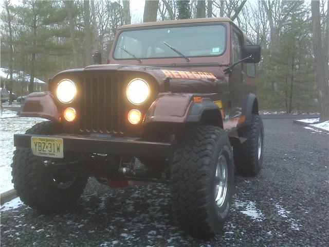

Rebuilding my CJ7 wide track and realizing I really prefer the look of the narrow track CJ's. I know, their not as stable but I only putt around town anyway. So what is the best way to get that look? I have a lot of $ in my existing axles with gears, locker, one piece, ball joints etc. Can I buy custom inset rims???? Will my tires rub if I do? I'm running 35's via soa.

Yes, you can compensate that with the rims and yes it might rub on the leafs when you turn the steering all the way to the locked position. I really like the stance of your Jeep but if you really want some narrow tracks, let me know where you park it so i can park mine next to yours and maybe the axles would mysteriously just swap out. I have the oh so great piece of crap 2.73 gears on the 20 rear and 30 front.:D.
Man, how do you run 2:73 with those tires? I guess with a 360 it doesn't matter. Yeah I'd like to tuck them in 1.5-2" I've got 15x10 eagles. Wonder if 15x8's would do it but not sure if they'll hold a 35x12.50???

Yes it will. I have two other sets of tires and wheels in my shop. One set is a 15X8 with the BFG Mud terrain baja champions. 35X12.50 15". The one on the pic that i'm currently running on are 15X10 with 35X14.50 15" Pitbull Krawlers.
The wheels you have in the pic have very little backspacing. Go with an 8" wide wheel with more backspacing and you'll probably achieve the look you want. You can measure your current backspacing by placing your tire face down on the ground. Hold a flat edge across the rim from edge to edge and measure down to the wheel mounting surface.
