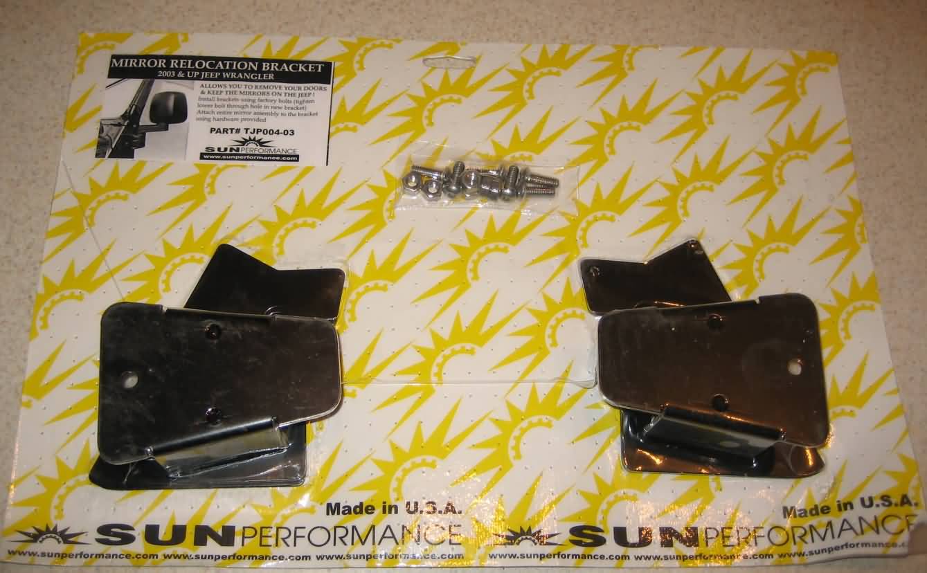

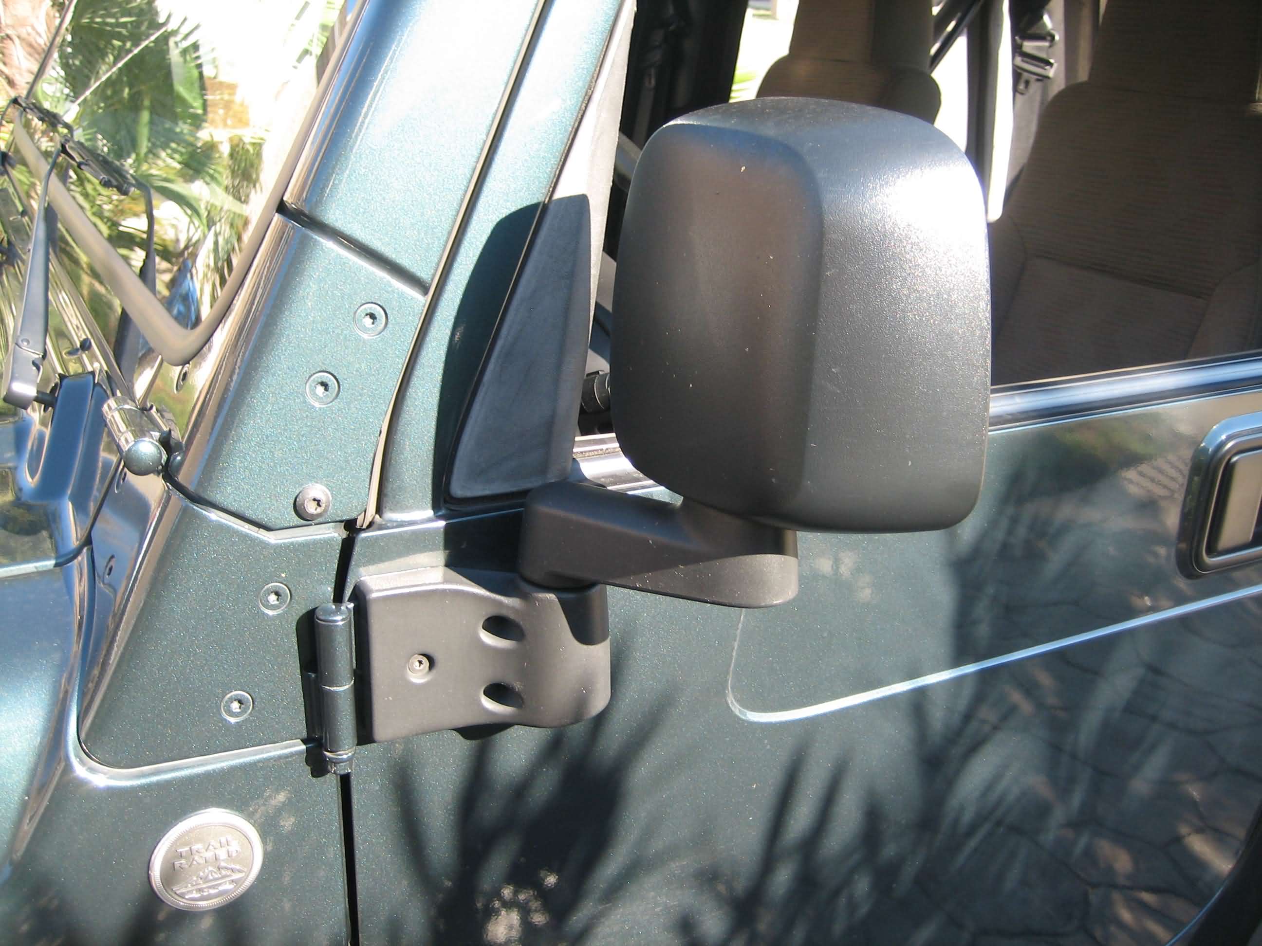

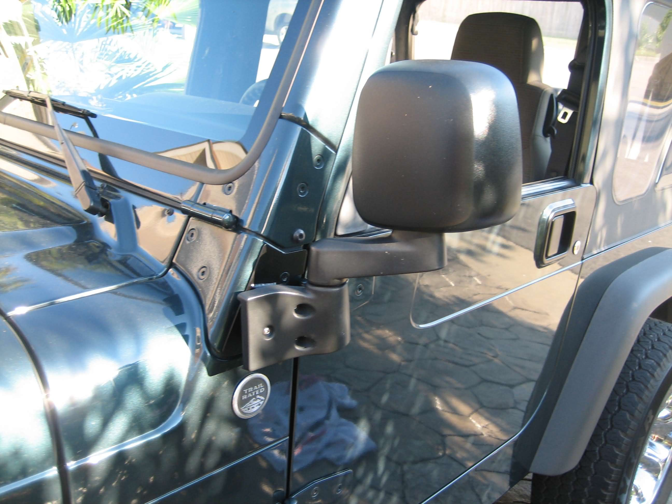

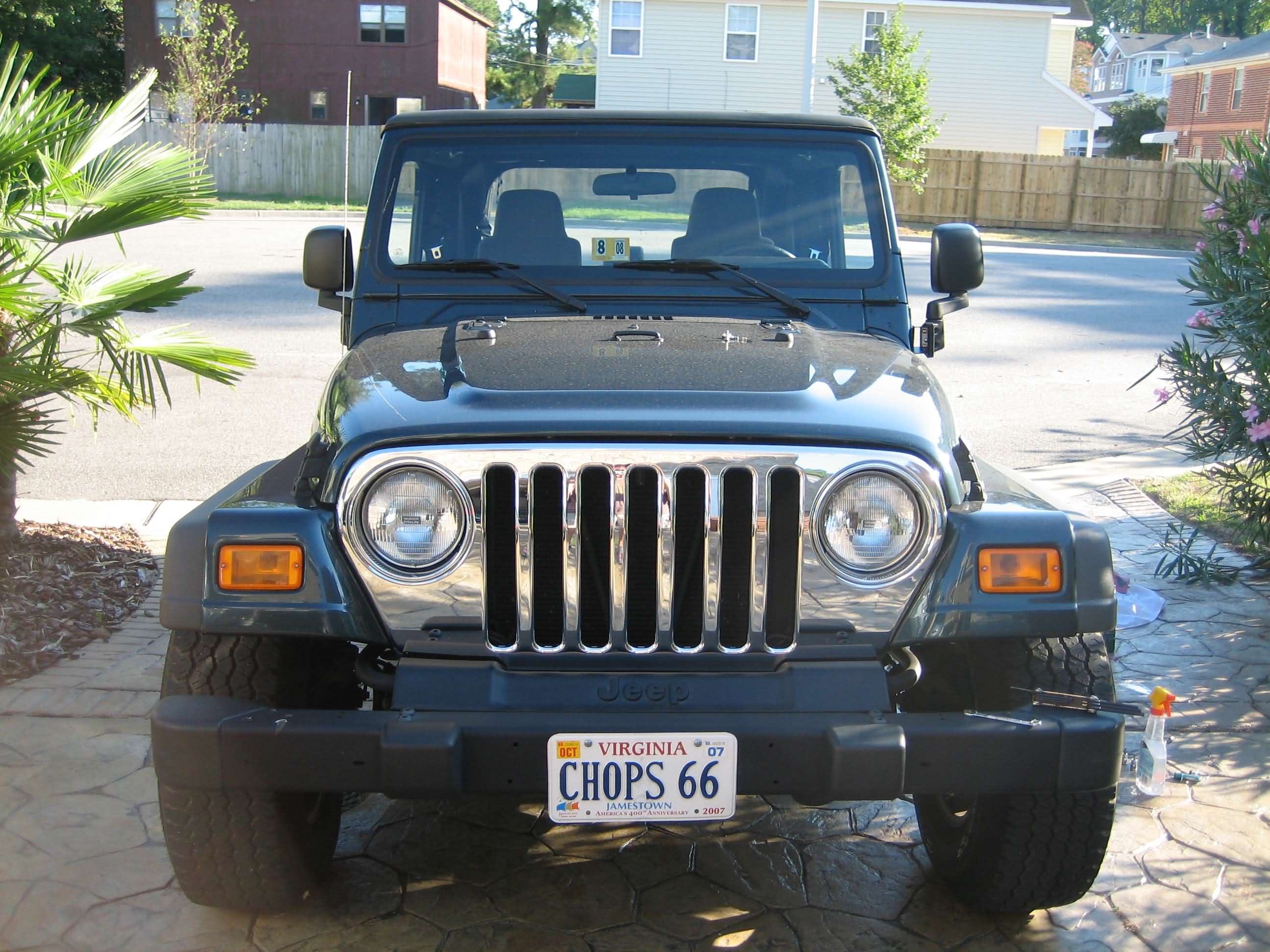

I love taking the doors off of my 2005 Wrangler, but in Virginia, you have to have side mirrors to stay legal. Thanks to Quadratec, I was able to move my mirrors from the door, onto the body of the jeep using these:
The are manufactured by Sunperformance (part number TJP004-03).
http://www.jeepz.com/forum/4x4-vendors/24192-mirror-relocation-brackets-light-brackets.html
The work well, and are very sturdy, overall I'm happy with them.
The only negatives I are that the mirror is now moved farther forward, and the passenger side mirror is difficult to see with the doors on. Also, if you open your door wide, you will bump into, and move the mirror. To fix this, I purchased new, adjustable door limiting straps from Quadratec.com

The before photos
The before photos

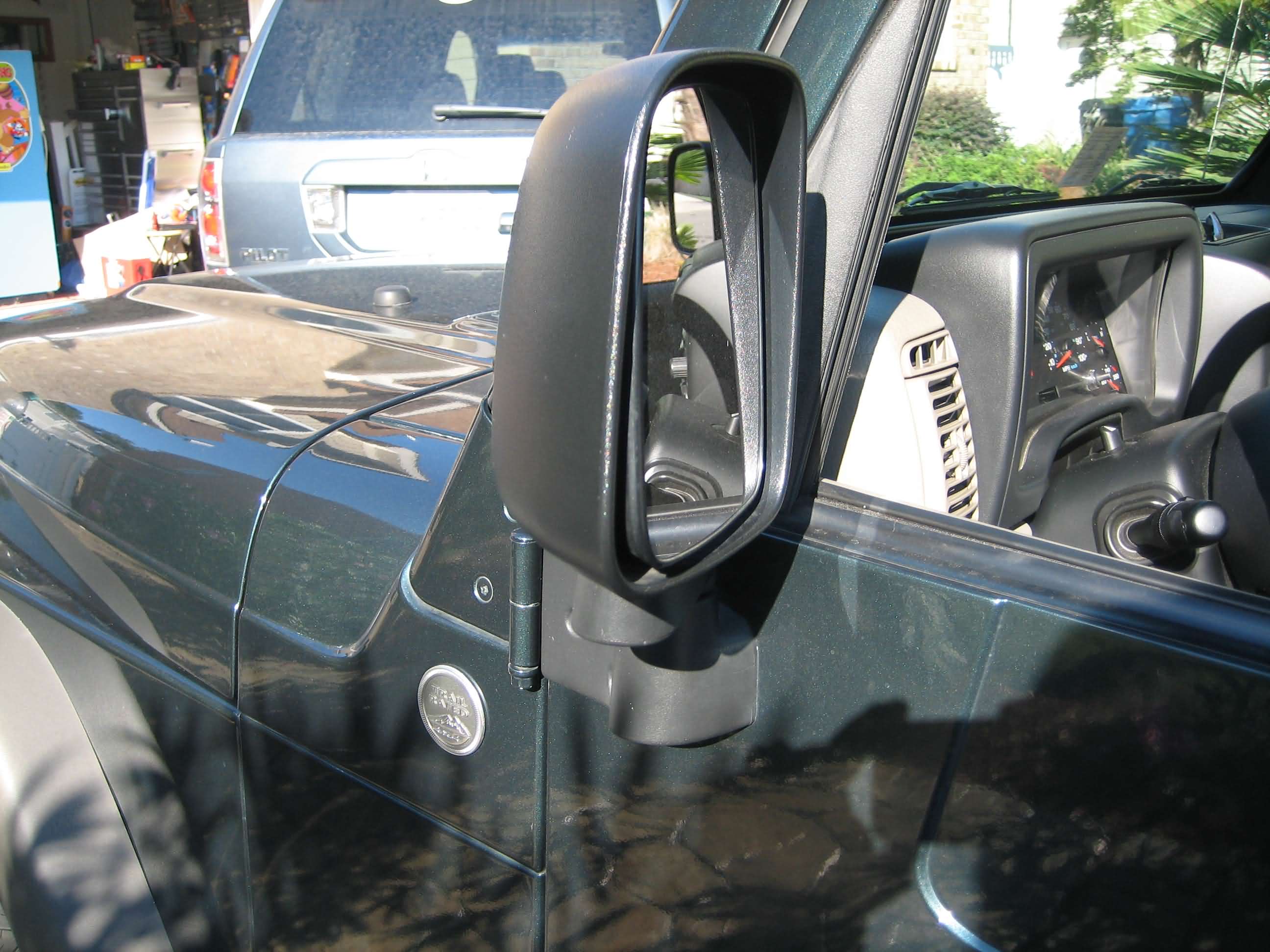

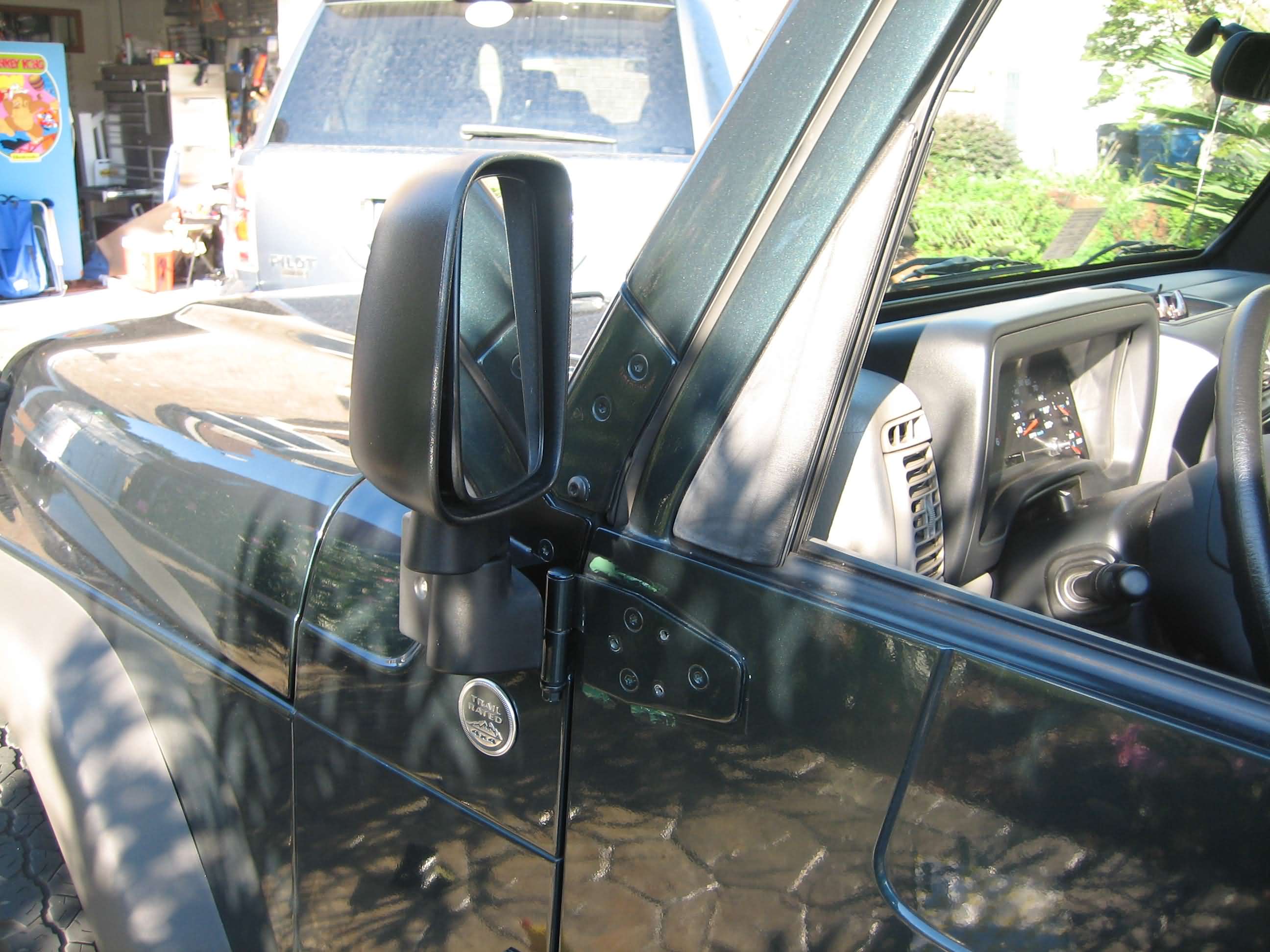

The after photos:
Here, the driver side has the mirror mover installed, while the passenger side does not

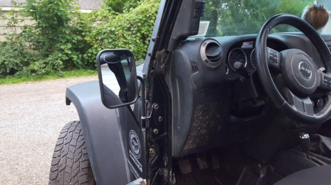

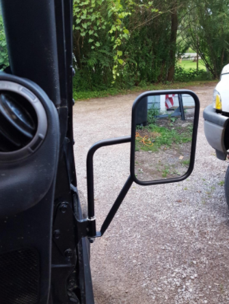

I went to a Harley Davidson MC dealer & bought a couple of extended arm MC mirrors. Threaded at the bottom, they just slip into the door hinge holes. Easy to remove when you put the doors back on.
Did you do anything about the holes in the door hinge? Just curious in case I do this next summer.
I just left them empty. One thing I did have to do was buy some touch up paint, and paint where the original mirrors had rubbed the paint off the door. I may go back and put some painted bolts into the empty holes.
I've done the same on my TJ (a number of years now) - and I have a couple of observations. The passenger side mirror is worthless now - doors on or off. You may be in compliance with the law, but you won't see anything out of it. I am going to move my passenger mirror back to the door - I don't think I need them both in CA to stay compliant...and if I do....I don't really care.

"I went to a Harley Davidson MC dealer & bought a couple of extended arm MC mirrors. Threaded at the bottom, they just slip into the door hinge holes. Easy to remove when you put the doors back on."
I have been screwing around with this mirror relocation business for hours. None of the bracket solutions seem very attractive. The extended arm MC mirrors sound real possible (What are MC mirrors?) I would like more inf on what I am looking for at the Harley dealership.
Also, I just saw an ad someplace on this site for snap-on mirrors from a company called (I swear) "Rocodile." Anybody know anything about that?
I also use the harley Mirror. I had one in the garage. It fits right in the hole. Mine is a custom mirror. I would buy the stock , square rerplacement mirror. It must be harley because i think the others use a thicker shaft.
Re: Mirror Movers - Relocate your Wrangler mirrors and take your doors off.
I bought some cheap round MC universal mirrors off of Ebay...works like a charm.
