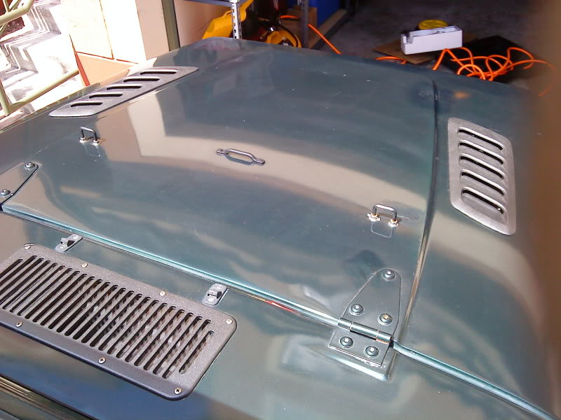

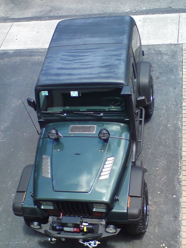

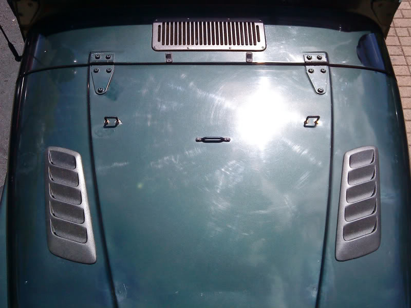

I put some on mine, and they do help keep the engine bay down. Even when parked, you can feel hot air coming off the engine bay. I do expect, though, that it does not work as well standing still as it does driving at 55mph. By the way, I went the junkyard way with mine; I got some Pontiac GTO ones that were $20, painted them and installed them with 3M automotive double sided tape. Have been on for over a year now without issues.
By the way, I should point out the louvers will cool the engine bay, but NOT the engine itself; this you can only do 2 ways; through the radiator (I recommend a Ford Taurus fan and aluminum radiator if you really want to keep the engine cool; you can get both for under $200 if you look online hard enough and visit a junkyard or two for the ford fan) or through an oil cooler (if you have a stick and the radiator has a transmission fluid cooling setup, you can get a sandwich adapter for the oil filter and route it through the radiator).
Keeping the engine bay cooler means that if your intake is in the engine bay (I have a snorkel, so it does not apply), you are breathing cooler air, which helps increase power. Also, the components under the hood will not deteriorate as fast (I did mine because I got tired of changing cracked vacuum lines).

Those louvers dont look too bad and are surely alot cheaper than having them punched into the hood.
By the way-good lookin jeep!

Thanks. I think for under $30, I cannot complaint for the louvers!

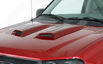

i added hood scoops like these on my xj with 2 small electric fans forcing air in helps some at slower speeds there on a switch in the cab they run me $95.00 with the fans
type in hood scoop in google theres lots of places to get them
easy to mount they use double sided tape mine have been on almost 8 years and a 3 inch hole saw to cut out holes in hood to mount little fans
