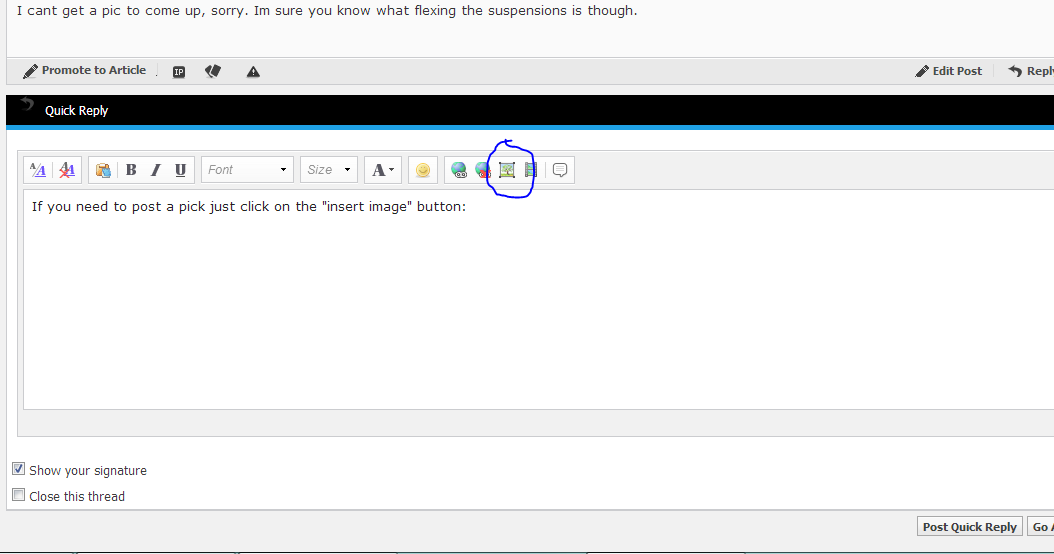

I cant get a pic to come up, sorry. Im sure you know what flexing the suspensions is though.
If you need to post a pick just click on the "insert image" button:
Or, if you'd like just email it to me (webmaster at this site dot com)
