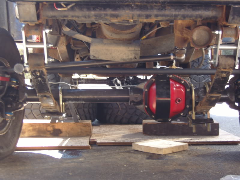

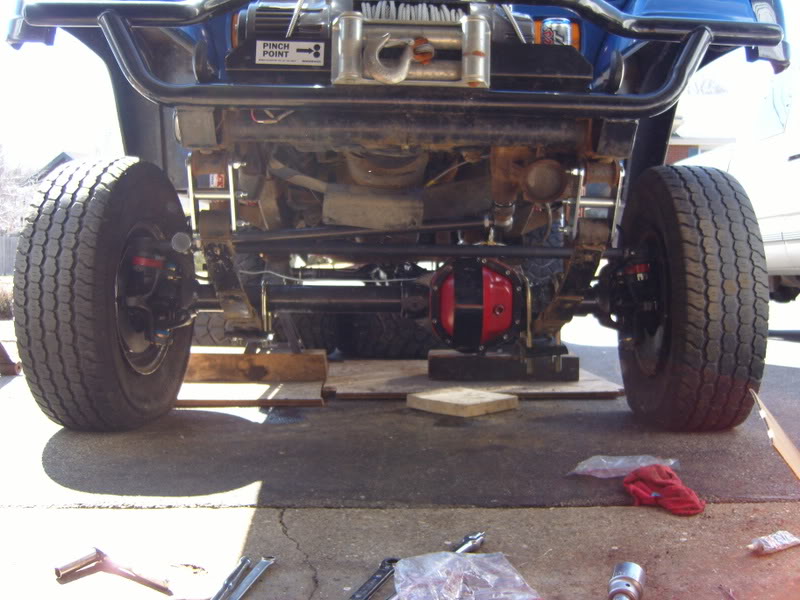

I put a 44 in the front aof my YJ last weekend. lots of planning and engineering, depending on how in-depth you want it to be.
