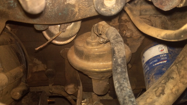

Ummm i just pulled the pump? I have no clue on how to open it? No screws no nothing.
Any one know this type of pump?

Mechanical fuel pumps are a non-servicable. Just replace. There is no fuel filter inside it by the way.

Yeah, you have to replace it. They are not very expensive. If follow your gas line back to the tank you should find your fuel filter somewhere along the way probably along the frame rail. It will probably look like a small can. Any of your local parts stores should have the pump and filter.
