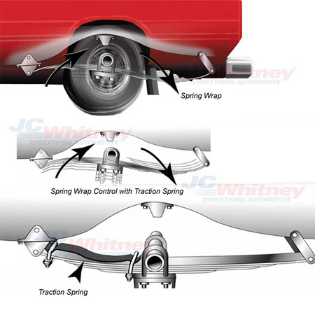

even though i went with another lift, i was wondering if traction springs like this one will reduce axle wrap

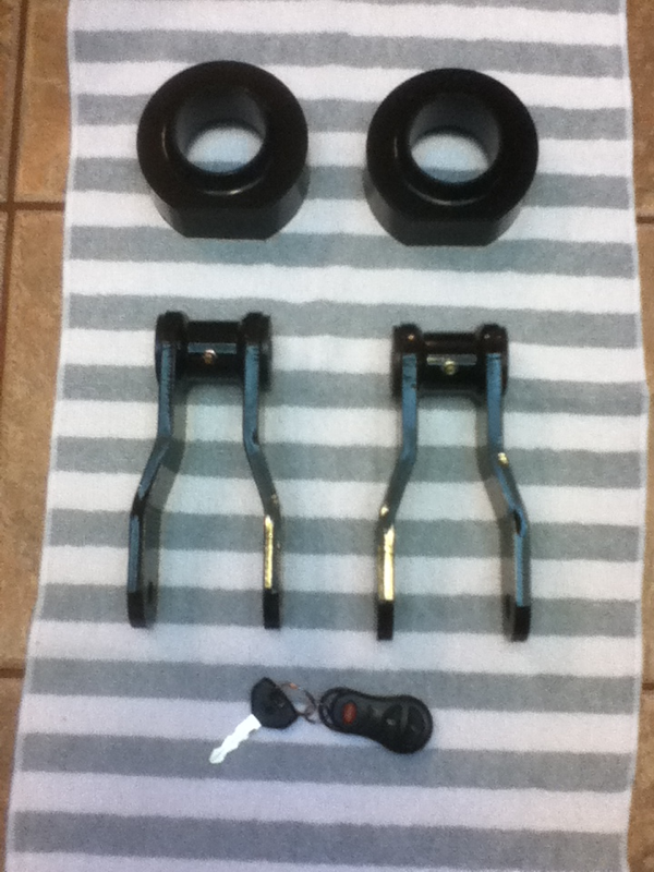

ordered the shakle spacer bb lift from rustys three days ago and its here :D
cant wait to shed some stock parts :)
