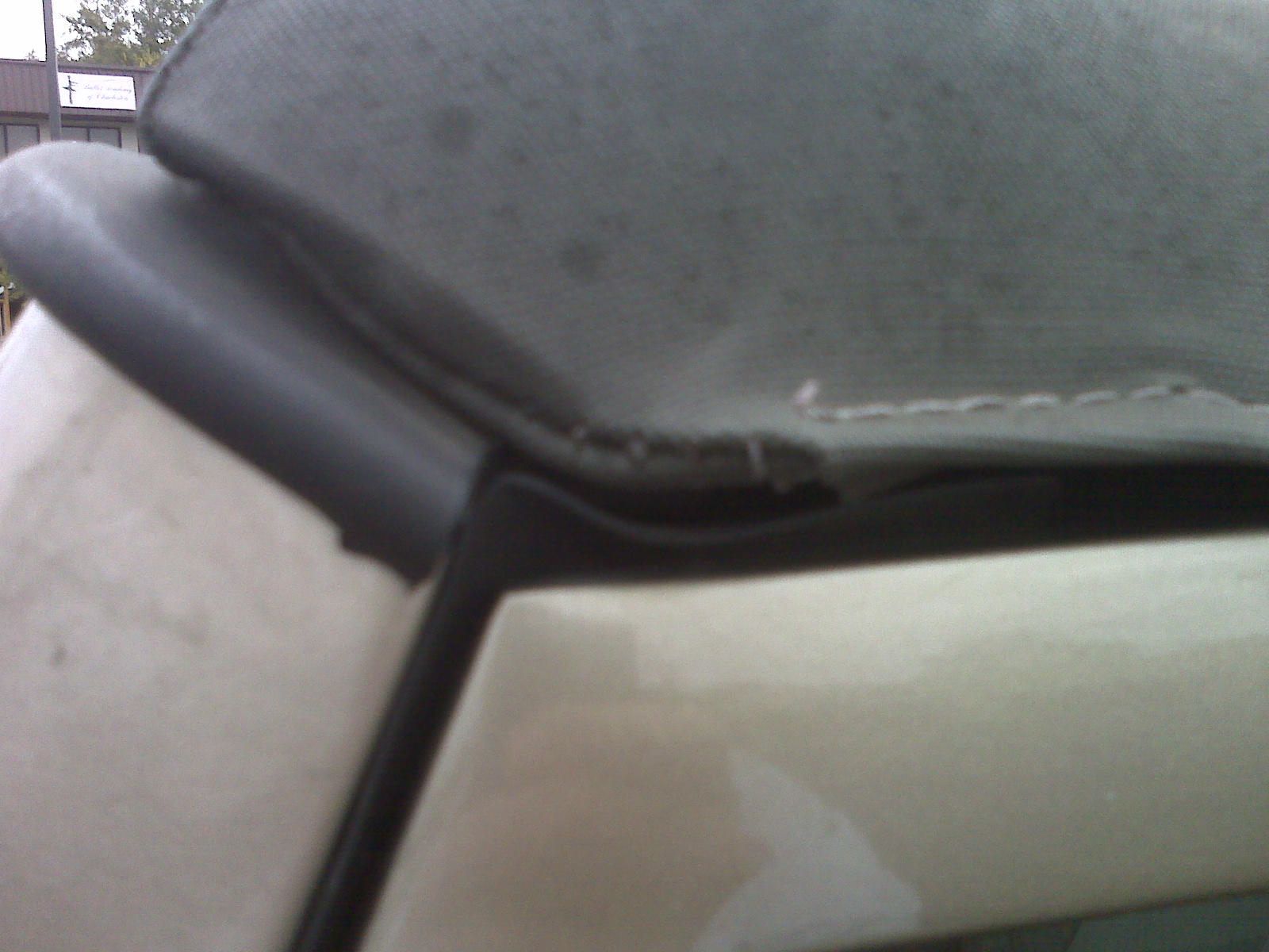

I have the same model as you and have the same problem but on the drivers side. Nearest I can figure is that the water comes in where the weather strip is bowed out some in the below picture. That's the only place I see a problem. I resolved mine by pulling the drain plugs and replacing the floor mats with rubber ones that hold the water.
I'll probably replace the weather strip later.
